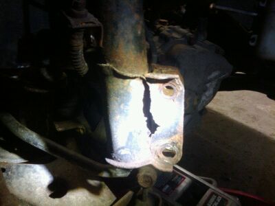

well today primo tore into my car and what they found wasn't pretty here is the story stright from mike
Originally Posted by blageo23 View Post
"Hey man, Im sending you a PM vs calling you because its after hours and I dont like calling customers after hours. lol
But I ran into some issues with your car. The front struts are bad, Where the shock mount mounts to the strut body is no longer attached. It rusted through. I honestly dont want the car to leave like this. It is not safe what so ever. I dont know if you have some free time tomorrow and want to come look at it but you need new front struts. Either PM me back or call the shop tomorrow and we can see where to go from there.
Thanks,
Mike Blageo
Primo Performance"
soooo tomorrow morning im gonna go take a look at it(ill snap some pics) and decide if i want them to do it, or.. do it myself seeings how im a little tight on cash since the wify is pregnant.. lets coss our fingers lol

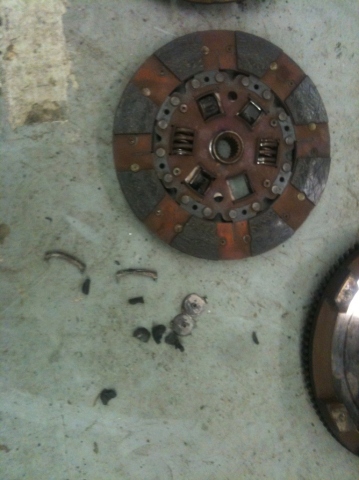

well i got the struts to mike today and took some pictures of the carnage we discovered lol her are some pictures
the top picture is of the exploded clutch which i honesly dont know how happened its like it welded its self to the pressure plate and the friction surface on the back was broken up and the rubber cushions? idk what to call them, were all distoryed lol its quite impressive
the second is of the rust on the strut mounting bracket it was pretty bad..

Is that a Centerforce clutch?
Ouch on the shocks! At least some KYB GR-2 replacements aren't too spendy. Might as well get some lowering springs while they're out
i couldnt tell you when i bought it i was told it was a stock replacemnt.. i have never seen one like it it had a stamp on it that say dk me and mike could only figure it meant DRIFT KING!!!!!!! lol but yeah it was pretty crual lol and on the lowering springs, newborn babies dont like bumpy rides and the mn highways are realllllly bumpy this all this snow we got lol
