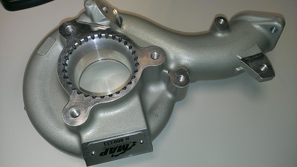

Old 01-10-2013   #88
Re: From ashes
You need a MAP anti-surge housing instead

Based on what Tim made, I assumed I would be right in the 425-430 range. I was right on, at 425whp/366tq@30psi
The turbo wanted to keep going, but we ran out of pump with out the BAP, like Tim has.

Re: From ashes
Nice! BAP or W400 and give yourself some nice safe headroom
