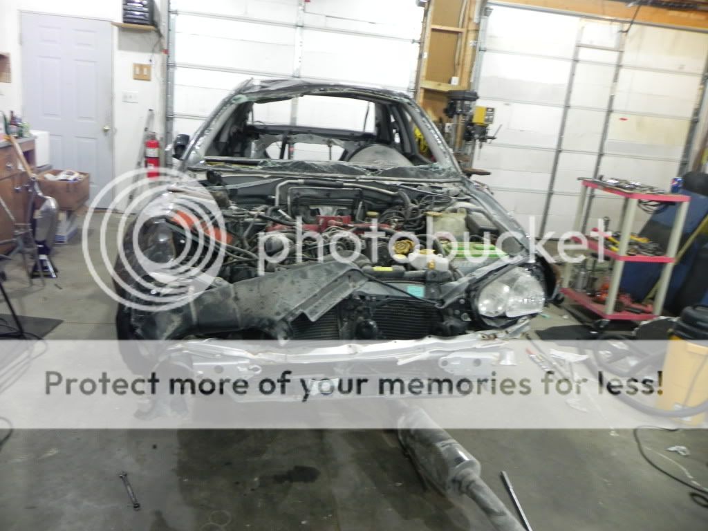

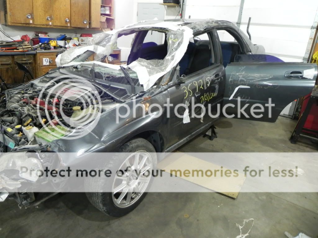

Luckily I came accross a 2005 STi that was totalled. I shot the guy an offer of $4500 for it and he took it. I scrounged up the cash because I figured that I would spend at least half that much just fixing the tranny and if I did the swap I could possibly make the difference on parts from both the STi and WRX that I sell. So if anyone needs any parts from an 02 WRX shoot me a PM and I'll see if I got what you need!

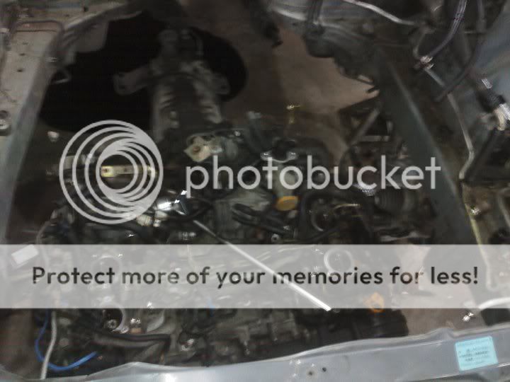

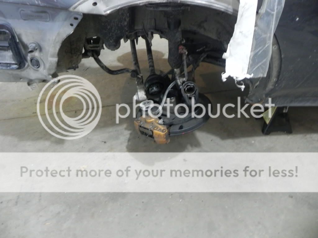

So on Sunday October 24th, I picked up the totalled STi. The STi had been rolled over but mostly sustained front end and passenger side damage. The biggest thing was that the rear pass. side strut and axle were broken completely off. Otherwise, most other parts that I needed for the swap were in good condition. The motor started and ran decently well at the junk yard. Here's a few pics of what it looked like.
as you can see it was in pretty rough shape.

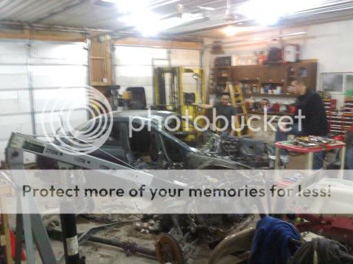

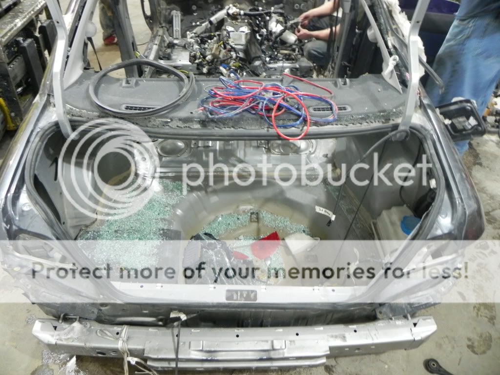

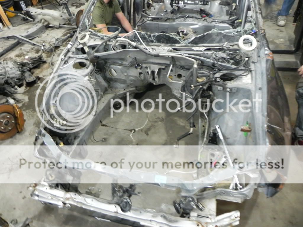

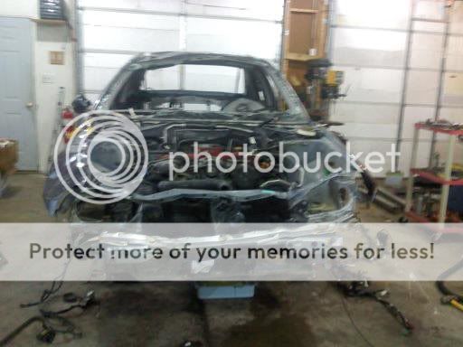

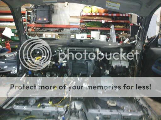

Right away that night, a good friend of mine and I started taking apart the STI until about 3 am. Throughout the whole next week we put in many hours between our jobs and other things...

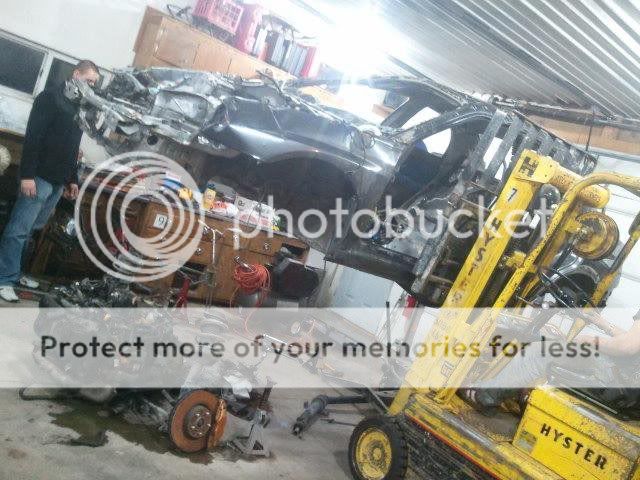

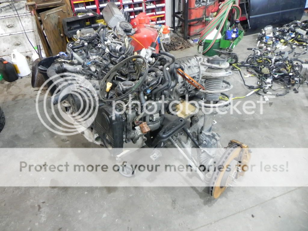

Luckily we had a forklift handy. Making the drivetrain swap relatively simple ---- Undo wiring in engine bay and all the other crap, unbolt subframe, lower motor, tranny, diff, suspension parts to the ground and forklift the body away. And the same thing for the WRX. We just threw everything on dollies to make for an easy transition!

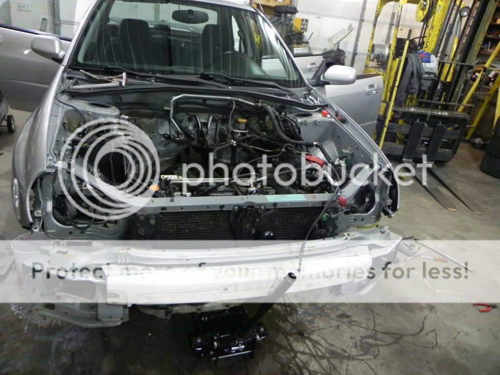

Then we brought in my 2002 WRX and did the same thing. Stripped everything off it, even all the wiring (except for the rear harness).

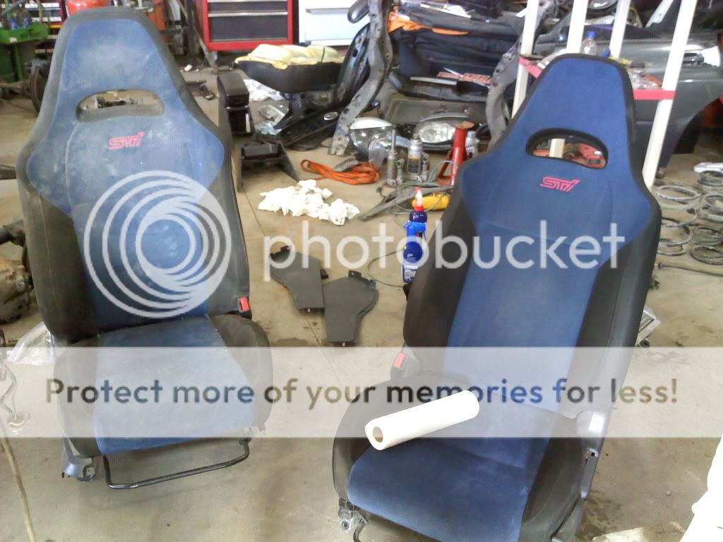

Now we're just about done. Today I finally got all the interior in. Tomorrow the rear axle should be done being rebuilt (since I counldn't find a rear STi axle anywhere!). Had to order two used BBS wheels because two were bent pretty bad (1 will make a good spare).
Unclean and Clean!

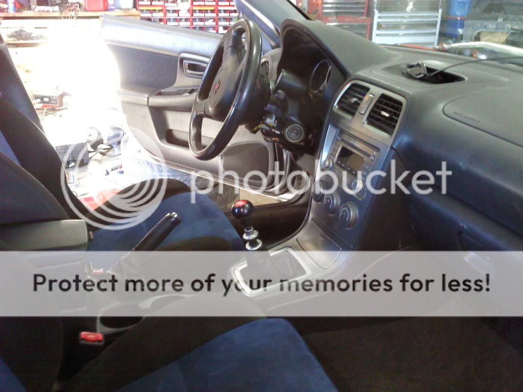

Hopefully will have it driving tomorrow! Complete swap in less than two weeks while holding a full time job!
