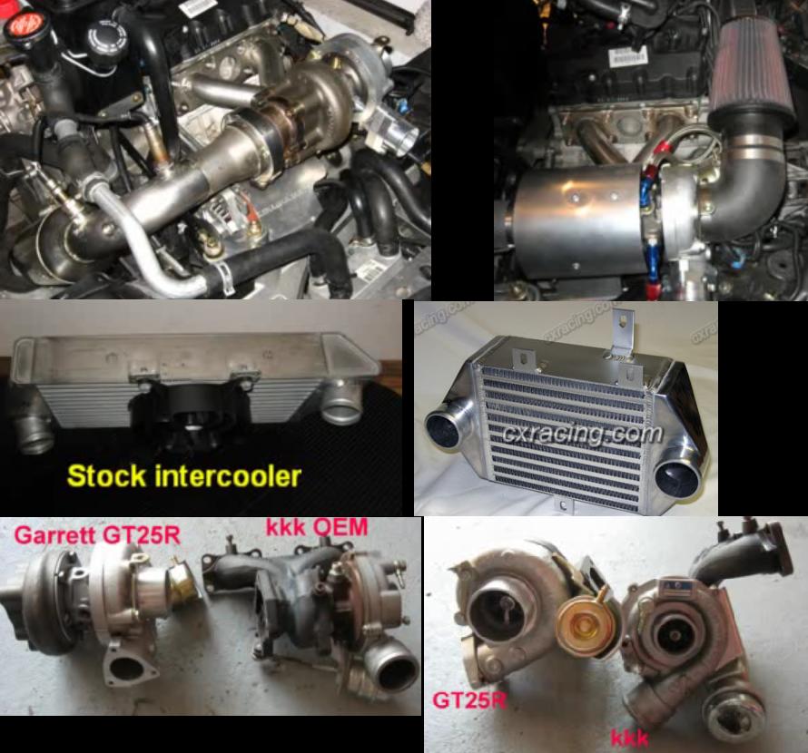

The reason I would like to use 2" piping is because the intercooler I intend on using is an upgrade for a Toyota MR2. It just happens to be about the same size as stock intercooler on the FST only a lot thicker.
It also has 2" inlet / outlets on the end tanks and even has tabs in the same spot for mounting the intercooler and retaining the stock fan on the back of the intercooler for cool down.

I attached a few photos.
That is a GT25R on a FS-T, basically similar setup I would like to go with.
Also stock intercooler vs. ebay CXRacing intercooler and GT25R vs Stock Turbo.
looks like a big exhaust housing to be spooling
