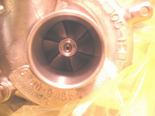

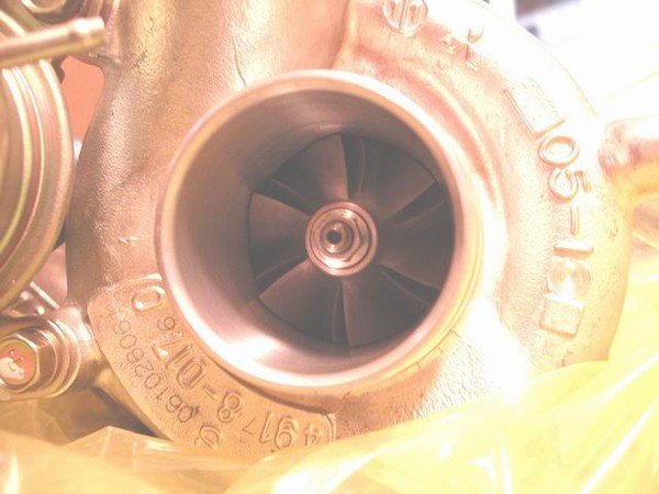

So, my friend with a very nearly stock conquest just upgraded from the 12a to an FP-made big 16g turbo.
At the same boost level as before (13psi) there was no difference from stock. We were both expecting it to be at least noticably faster, yet it was not. So we turned it up to 15psi, pretty much the same thing, almost imperceptibly faster. We looked under the hood, and one of his couplers wasn't holding the pipe in, we though that might be contributing to the slowness, and we replaced the pipe with the stock cloth-wrapped rubber hose. No change.

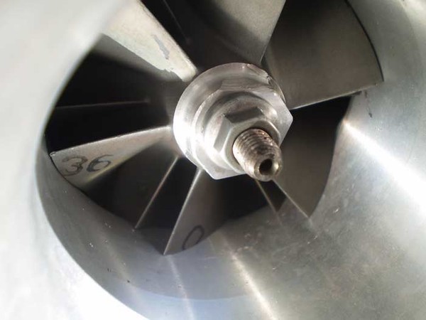

I had peered into the exhaust and inlet of this new turbo, and it is slightly different, a little bigger, but there looked to be a larger-than-normal gap between the blades and the housing walls. He didn't take great pictures, but could even a slightly too-large gap cause a turbo to perform so badly?
here are his pictures, plus one of my 61 for comparison:
Just looking at the stock turbo, the gap was significantly smaller on both intake and exhaust wheels. Could FP have messed this up?
Also, he has the stock exhaust with a downpipe and different muffler, but even so, I'd think we'd be able to tell a difference just switching out turbos.
His exhaust made an incredibly loud hissing sound when he'd get on it. It's kindof like stock cars flooring it, but just a lot louder.
Any ideas about this?

Re: why new FP big16g no make power?

I'm really thinking now that the exhaust wheel is normal and the housing is an H housing, since it's different and the blades aren't as close as they should be to it.

He might have a point. When my talon was stock the very first thing I did was swap the blown 14B for a 16G. I couldn't tell the difference, even at slightly higher boost levels. That said, I would start with a boost leak test.

Fatty, he's right. 16g vs 13g vs 14b is not going to make much difference at 13psi or whatever. First question, are there any boost leaks? Was there an actual boost leak test done? Next question, what other mods are done? Spaz's car is a prime example of why a 16g won't make any power over a T25. He's running it with literally everything else stock. Remember, making power is all about the combo, not just one particular part (remember at the dyno day when an hta88 made the same power as my 16g-sized turbo?).

Do an actual boost leak test. Myself and lots of others here have testers you can probably borrow. But I still say you wont feel much difference at those boost levels without additional mods

Does anyone know how much gap there should be between the turbine blades and the housing?
