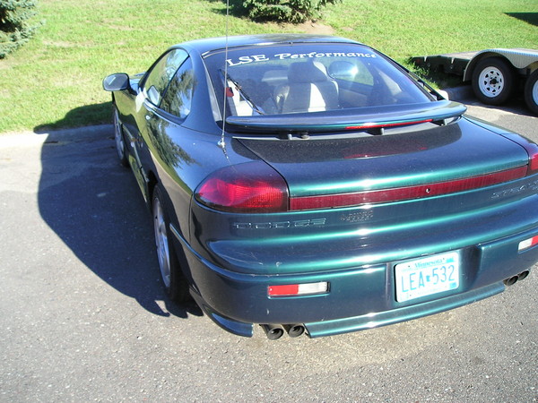

So, as some of you may know, a while ago I picked up a 92 Stealth TT for cheap. (thanks Joe M)
I put the tranny back in with a new clutch and output shaft, and had a running driving TT. It has higher miles (~142K now) but the body's not bad, it was mostly re-done after hitting a deer (before I got it) I put a bit over 6,000 miles on it, and took it to two road course events. Well, one and 1/8th road course events. The first was Mid America Motorplex. It had overheating issues and I had to take it easy. Next up was Road America. For those of you that don't know, Road America (RA) is a 4.x(2?) mile road course that's over in eastern Wisconsin. I got about 5 laps in and then... This \/ \/ \/ happened.
Needless to say the car was towed home. The biggest disappointment was I missed out on A LOT of track time. I had installed a Koyo radiator and wired my fans full on for RA. I put the boost at waistgate pressure, just to be sure it didn't have any issues. I took 3 laps to make it to operating temp. 200 HP. I did pass a C5 with an owner that was driving conservatively, and hit at least 135 MPH 2-3 times per lap. I'm pretty sure the crank got broken as an after the fact thing. At the track, there was a hole in the block, as it made a nice puddle of oil where I parked to get towed off track. The motor still ran when I got it home, not making much noise, but with a bad vibration (no piston/rod). I started it to drive it to it's parking spot (no one to help push) and then it made a clunk and never turned over again.
So, instead of partying it up on new years I spent my time putting this in.
And my car's back to a running state. Yay!

Just a broken crank. It's the weak one anyway. 91-92 came with 2 bolt main blocks and cast cranks. 93+ (TT only) got 4 bolt mains and forged cranks. The motor I put in is a 4 bolt.

Woah there tiger, those turbos are certainly not stock. What be they?

I didn't think anybody on here would know the difference. They are TD04L 19T's. They start of as 13T's from a Subaru WRX. Not sure what I'm going to do with them at this point, but my 9B's were about dead, in-out shaft play. I had these so I put them on. This it the first time I have owned a turbo car with upgraded turbo's. The clutch I put in is a stock replacement from SBC, I'll just turn it up till that gives up and call it a day. I don't want to spend all my time on this car, I have a 93 RT TT I want to get going. That one will be a bit more intresting.

Why not tell us then? That's a pretty cool but how much power do they put down? Are the comparable to a 14b or something much bigger?

As far as the turbo's, it really depends on the rest of the setup. I'm not trying to get all I can out of them, I'm looking to get 300-350. That should be at the limit of the mild clutch. They should be able to do ~400.
It would be better if I had the upgraded exhaust wheel. Mine have stock WRX exhaust wheels. Stock for a 3S is TD04. The WRX's are TD04L, they arn't much bigger. TD04HL is a lot bigger (about 1/4"). TD04HL 19T's have done 550 AWHP on race and 513 on pump with heads and cams. But that's on a DD where the used the X key, so not quite that much for those of us around here. About 430-450 on pump with heads and cams, 475+/- on race with out H/C. Both those # are from the same guy.

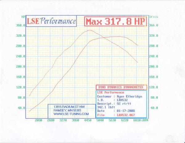

Yaya, post up some power graphs whenever you get some dyno time with that thing.
I assume the X key on a DD adjusts the correction factor?
Old 01-07-2008   #19
15min late to the world
Re: My Stealth TT, dealth, then revived
In the bar screen you hit the X key on the keyboard and there is a correction factor you can type in. Normaly this is 1.000 but you can take power away or add as much as 3.000. This will change the power and torque reading in the bar screen and the graph screen. Or if you load up a graph from any car you can add or take power away. If the dyno run was done with the correction in place it would show up in the Snap shot file. If you type in 1.130 if would add 13% HP and Trq in the graph screen and the bar screen. The way Dyno Dynamics intended people to display more power then the car was making was with Shoot out mode, this would give a more "real world" number.
