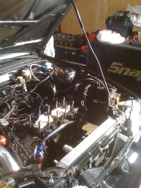

Well, been SOME time since I've updated this. So, as the car currently sits:
Head is torn off, to make sure no valves are slightly bent, and see if that is any contribution to the revving issue i've been having. Head is up at Rau's place, and It's getting worked over while it's off. 1mm SS valves, his beehive spring/retainers, seats, seals, etc. Also getting soda blasted, so the head will look brand new once it's done.
As for the rest of the car, I've made a bypass plug for the MSD, and I have wires, so I'm just looking for a stock coil pack, and then I'll test all the ignition components on the dyno come spring.

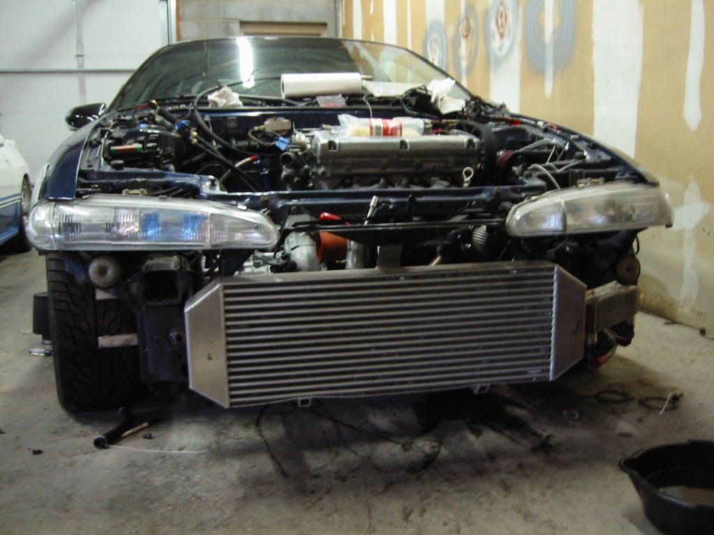

Steve Hill's old FMIC will replace the one I had on the car before, as his is thicker, and will help keep my intake temps down, farther then before.
