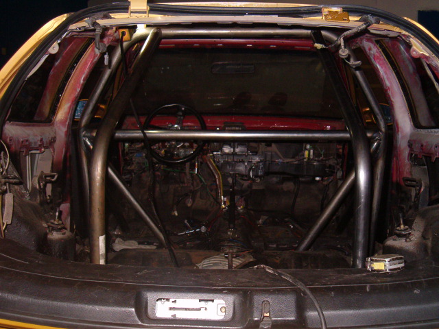

Re: Looking for a roll cage. Any thoughts?
Civic kit

Once the bars are all welded together the cage isn't coming out w/o being cut up anyways so you might as well weld the plate down too.

Your gonna have to remove it all anways to weld all the bars together. I know for a fact bolt together cages are not legal for any form of drag racing.
