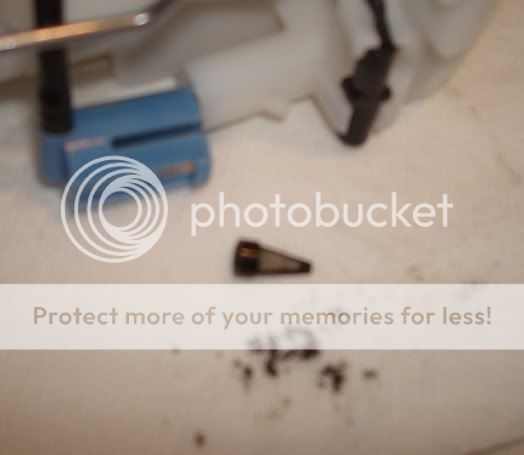

I was able to confirm that the hanger return is the problem. The one used thing that I buy (fuel hanger) and it has a problem. Go figure.
Now I'll have to find a source for that black slinky hose in the hanger for the return...they snap on so can only be used once. grr.

Photos don't really do justice for how tiny the filter inside of the return is. It was obstructed with very fine particles...looks like rubber and metallic bits.

Ooh, so maybe just cleaning it out will do the trick eh? Or are you drilling it out too?
I'll try it cleaned out first. I had a 255 in my stock hanger when I was STS so it really should work.

Drill baby, drill.
Huge improvement but fuel pressure at the engine is elevated by 10psi and at the surge tank by 25psi.
I need to figure out how to remove the return assembly from the hanger. I don't see what's holding it in.
