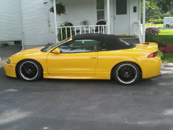

it actually has the stock struts with ksport lowering springs normally im not the biggest fan of spyders but this one is alittle unique plus im kinda thinkin gsx conversion

What is it exactly that you don't like about it being lowered? The ride or the look?

i love the look but im going all out on the motor and it makes it rather hard to get underneath the car when its an inch off the ground lol i mean the thing looks mean as hell dropped but ive never been a huge fan of lowered cars personally

Why not go with some Eibach ProLine Springs? They don't lower the car much at all compared to your current springs and not much more than stock springs.
They just make the handling a little better and get rid of a little wheel gap. I really think you will regret going to stock springs with after market rims, it just looks plain silly.

if your going all out on the motor your going to want the upgraded springs for launching your car and just use a jack and jack stands to get under it. they work wonderfully for me. I say just keep it lowered

^ +1. What good is having a lot of power if you can't hook up, or go around a corner well due to having crappy stock suspension?

i agree but for now its way to low for its own good gonna end up ripping the front bumper off

The yellow looks nice! Keep it lowered

ahhh u guys are killing me here lol if only it was like a inch higher i would feel better and wouldnt break shit lol

Car looks mean! Keep it the way it is.

Get some quality lowering springs instead.

A lowered car doesn't mean better handling or better traction. Slammed cars are usually horrible. And that might be what he is getting at. Hell, for FWD drag racing, you don't want it low, you want the front bumper low, but not the car. You can't fit good tires when a car is too low and you want your axles straight, not at an angle for traction, power and less breakage.

u hit the nail on the head i think looks cool but its so low i dont want to break it and scrape the hell out of the bumper and wreck the paint kinda pointless just check the picture its wayyyyyyyyyyyy to low tires in the wheel wells no good already broke a cv axel cause of road construction and almost ripped my fmic off lol damn construction
