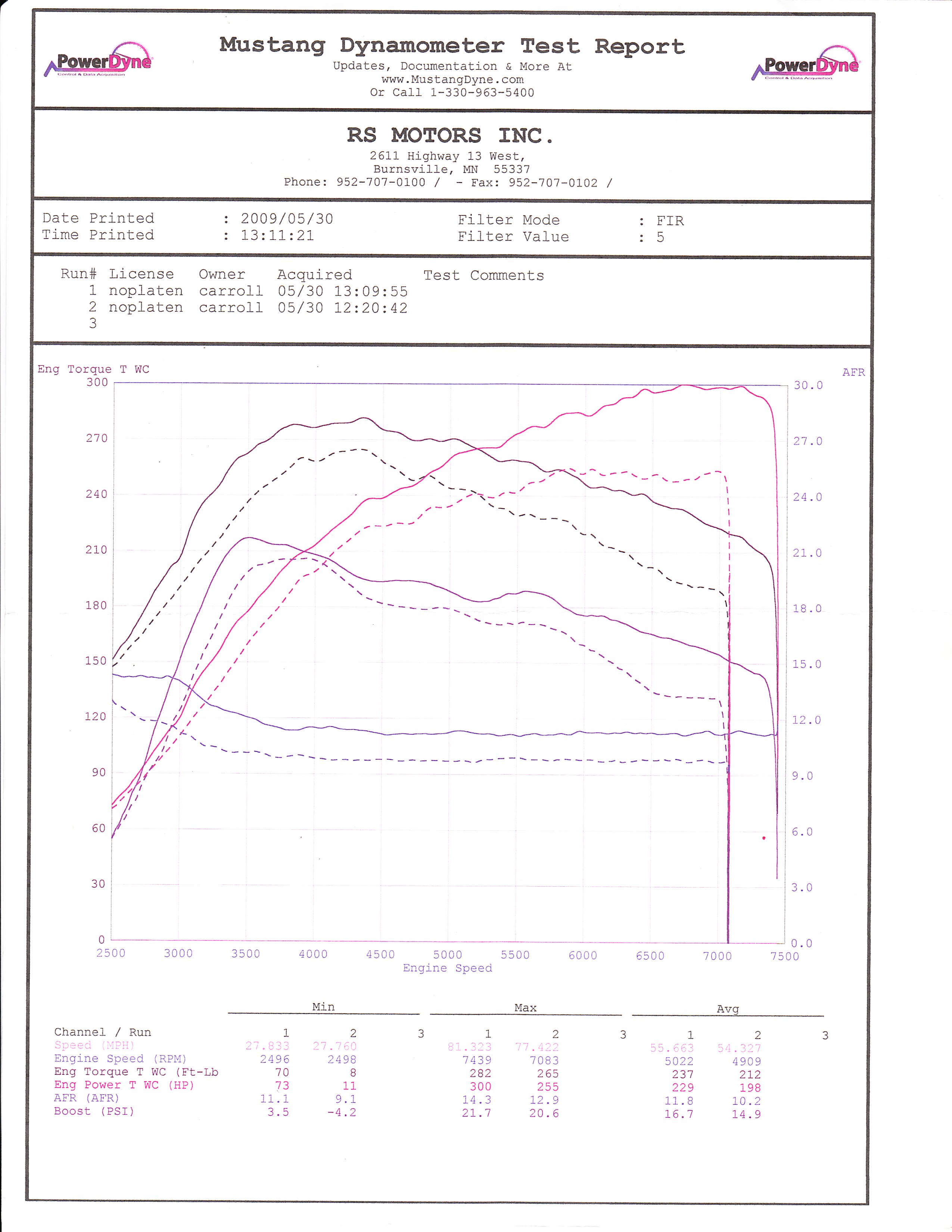

Scheides,
Awesome work! MBC, EBC, Boost control, smoosh control, the boost looks excellent what ever it is.
Mine is attached for comparison purposes this is bone stock tune vs RS Motors tune, yours looks great in comparison for the boost spike.
