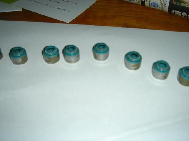

I blew my head gasket about a week and a half ago in the evo. I brought it to metro engine right in arden hills. They saw the surface and asked me where the hell did this get machined before. I had no clue cause I bought the entire long block from ron at rs motors. After the head was dissasembled I got a call from metro and they said I had one bent exhaust valve, WTF I said. I just dynoed it a few days before at map and made crazy good power on the fp white. There was no power loss and the timing was dead on when i removed the timing belt. How the hell could I bend a valve, here comes the crazy part. I got another call from metro today and they said that all my exhaust valves will need to be replaced cause there was wear on all of them. This head had less than 12k on it when the headgasket blew. Also the valve seals that were removed from the head were the incorrect sized ones. They all had unusual wear on them. All in all Im pretty pissed right now cause I thought I would just have to have the head resurfaced and then slap it back on with some L19 headstuds and a oem mls head gasket. Here is the wear on the valve seals

He told me the other day and then I forgot, to much shit going through my head to remember. I think I may go back to a stock longblock and just drive the evo for my daily and buy a different car to go fast in. Im getting sick of breaking my daily driver all the time. All I know is metro engine said that the surface of the head was machined very poorly and the exhaust valves were touching and wearing.

First thing he said was that the tune that jordan did caused the headgasket to go, he told me there must have been to much timing. There was peak timing of 10, im on e-85. Then when I told him I had bent valves,the valve seals were the incorrect ones, and the surface of the head was poorly machined he told me to contact the machine shop that did the head in the first place. I dont know what to think anymore, metro engine said that with me using a cometic head gasket and the poorly machined head surface, there was no doubt what caused the headgasket to go. Im not sure if I even want to keep my engine anymore, I think I may put my 500+awhp goal on hold and just enjoy being able to drive my evo everyday again.

Thanks guys, ya I am getting prices right now for all the parts I need and I should have the head back by the end of the week, I just need to wait on getting the L19 studs due to lack of cash. I knew something was up when I started to make less and less power on the 37r setup. All in all I think that once I get my car back up and running it will be done right with a properly machined head and 5 angle valve job with brand new exhaust valves. I will be shooting for 500 tq on map's dyno

Ya the head is fine, I am ordering the exhaust valves tomorrow.
