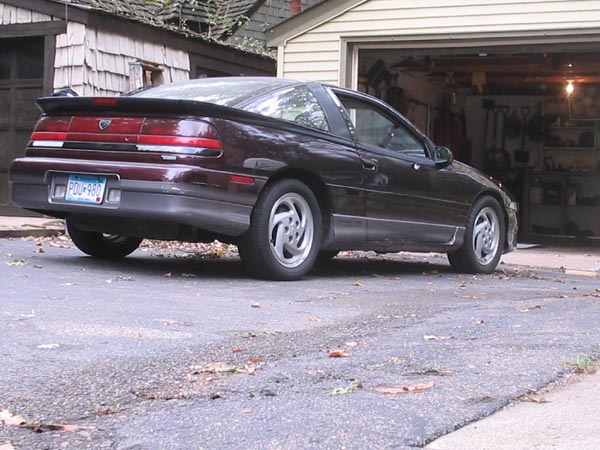

Well since everyone else is doing it, figured I'd post up my progress. Plus I'm getting a little antsy with it being so cose to road worthy. I won't get it to the point I wanted it, but atleast I can get it road worthy so I can enjoy it a little before snowfall. I've been working on this thing ever since I've been home and it's finally starting to look like a car again!
Car is a 91 Tsi AWD. Here is the main stuff I've done to it

That's the main stuff. I still have a few things left I need to do. I need pick up some slim fans, a fitting for the turbo, build the rest of the exhaust, and reweld a couple of the pipes that I found were leaking at the welds (that's what happens when electricians play with welders) The fun part of doing this all has been the fact that myself and Austin/IndiEP fabricated everything dealing with the piping with the exception of the O2 housing which I bought from RnR and fits totally wrong(buyers beware). My last car I had boughten everything, but this one we made everything ourselves. So there is a little more sense of accomplishment!

OK well anywho, here's the only pics I have so far. My goal with this car is for it to be quick (all i want is an 11.99 pass), yet still retain what creature comforts i can, which is why you'll see all the AC components still in there, and the Cruise Control throttle cables, and the fact that I'm reupholstering in leather, because that's all stuff I still want! Should be drivable here in a week or so I hope. I have my fingers crossed!!
