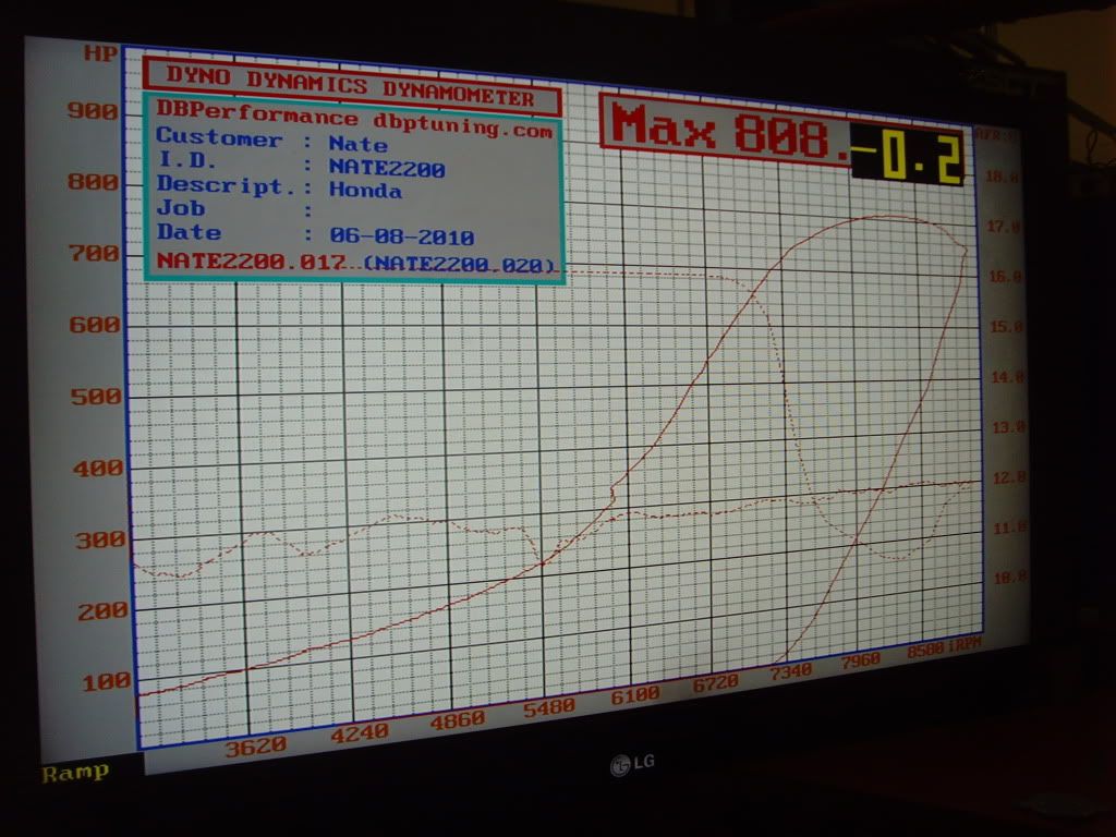

Huge thanks to Shane up at DB Performance for a great tune and late night up at the shop. After a horrible ignition set up for 5+ years I finally steped up my game thanks to LJ I got a M&W Pro10 with a Crane coil, and there was no more miss fire since!!! Shane and I decided to try and get a time out of the car went to B.I.R. for Proving Grounds and I got some shake down runs done. The car went 10.7@127 cause car was getting close to the wall and also went 10.8@146 on rev limiter just past 1000ft mark, just got to get the first 330' down and it might go fast! Shane and I are going to try some new cams and see if it will pick up midrange and top end power here soon!!!!!
830whp/546tq
33psi.

Don't have a photo of the 830 graph but this will do.
