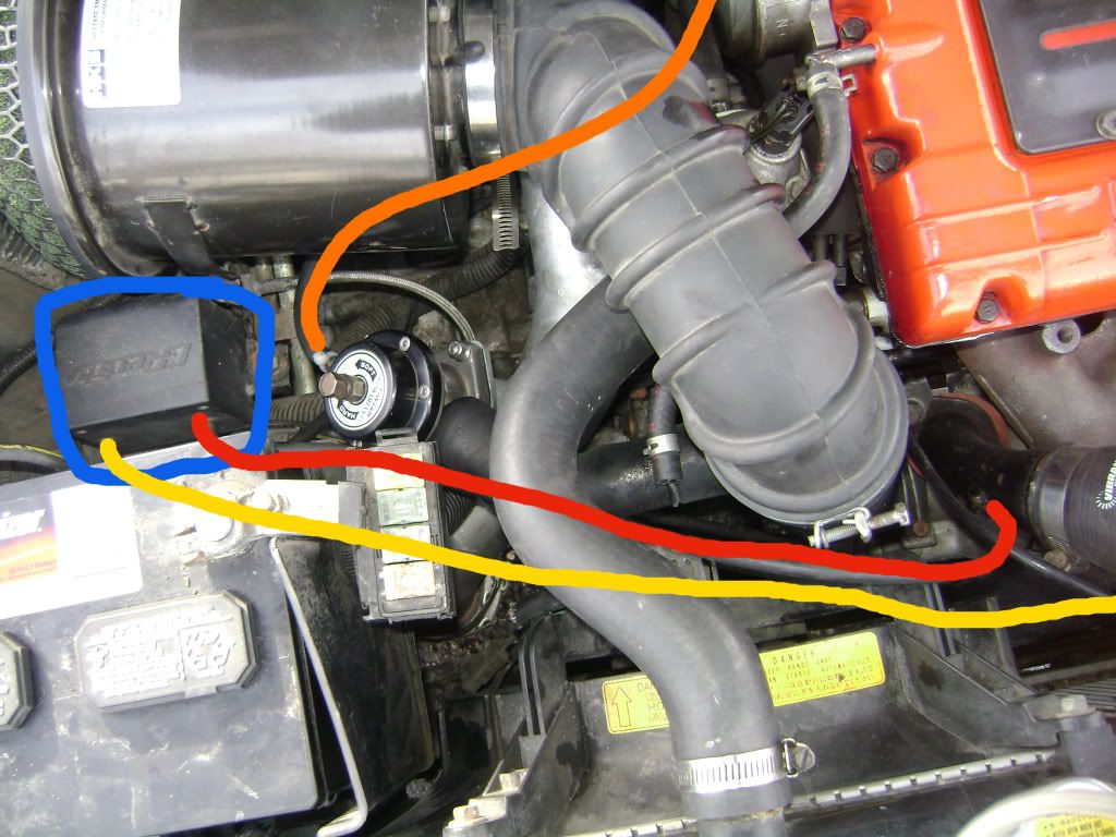

BLUE: Greddy Profec-B Boost Controller
YELLOW: line goes to wastegate
RED: goes to j-pipe
ORANGE: goes directly to the intake manifold
both the RED and YELLOW lines are not connected to the bov.

Well it looks like you have your vacuum lines run correctly. My tial does what you were describing, but that's cuz I have an 11 psi spring in it, so it doesn't open fully until there's 11 psi in the charge pipe.
