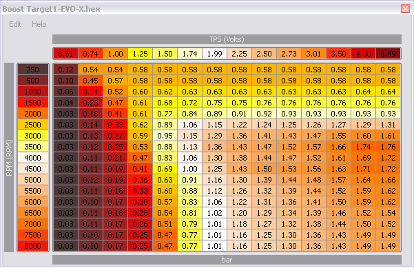

3d boost tables (tps vs pressure)
boost based on bar (i.e. pressure, not load!)

3d boost(target is in bar, 1bar =14.5psi):
