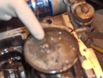

well friday Ross, Drew, and I went to go work on the talon's engine.. take a gander!
don't mind drews finger!! lol

Cool, what all did you get taken care of? I see the timing stuff on, so I guess you're all finished up with the rebuild process? Did you end up doing a stock rebuild, or throw in some fun stuff?

well it was just a bare block so we got all of that done in about 7 hours. So yeah finished with the rebuilding process.. I guess you could say i threw in stuff. I had all my mods on last time on the old rebuild then 7 miles down the road it locked up on me so thats why i had to do this rebuild again

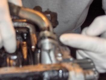

Who built the first engine which locked up and why did it lock up?

I don't know the name of the engine shop that did it the first time but it locked up because they didn't use threadlock on anything when they assembled and the oil pickup tube came unbolted and no oil got to anything for 7 miles.
