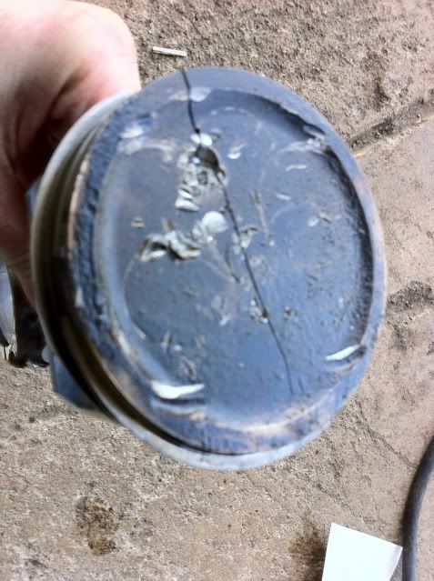

Finished stripping the motor down to nothing this past weekend. Block seems to be ok but there was a sligh scratch on cyl 1 and a little nick on cyl 4, 3 and 2 looked perfect though. There was one chunk of metal found, which appeared to part of the #1 piston that had a hole in it. No metal shavings in the bottom end is nice so the oil cooler/turbo aren't full of shit. Probably could have just ball honed it and threw some rods/pistons in it but then I'd want to throw a huge shot at it knowing me then I'd break something else
Thought this was kind of cool
I've purchased a stock long block for 2k shipped that I am hoping will be here by the end of the week or early next week so I can get a running car again. I will be slapping the stock turbo on there and just driving the damn thing till its paid off. Maybe get a lip or some stupid little crap but nothing cool.
After I can get it paid off I'll either build this block and make this thing quick or get another dsm for a track type of car.
Just a boring update but probably the last one I'll do for a while.

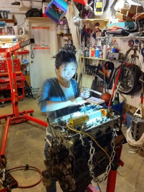

Finally got my "stock and factory sealed" long block yesterday from awd motorsports. Looking it over it has arp headstuds and had gates racing timing and balance shaft belts. Makes me a little worried but as long as it runs and doesn't leak I dont really care what's done to it.
Put my gsc s2 cams in it along with the gsc springs as well last night. I was actually surprised when my gf came and helped haha. Hoping to have a running car by the end of the week.
One more random before it blew up
