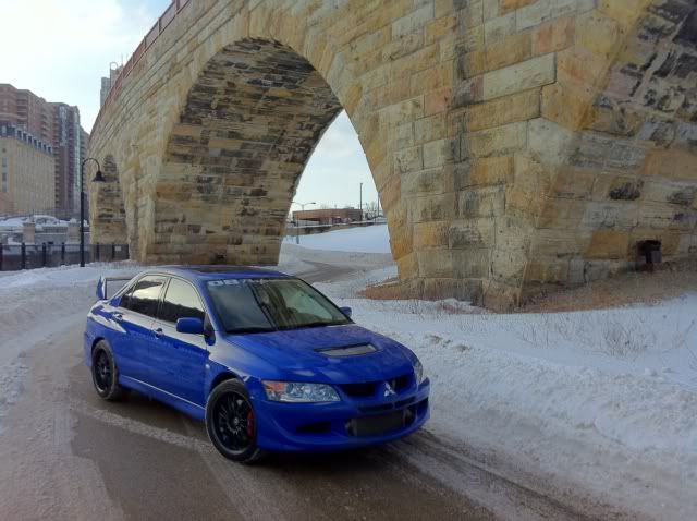

Random new picture I took the other day while board in muderapolis with the summer wheels on it.

Looks good, makes me wish mine was done.
Thanks! Yours will kick my ass when it is done anyways though, then I'll be the one with the sad face!
