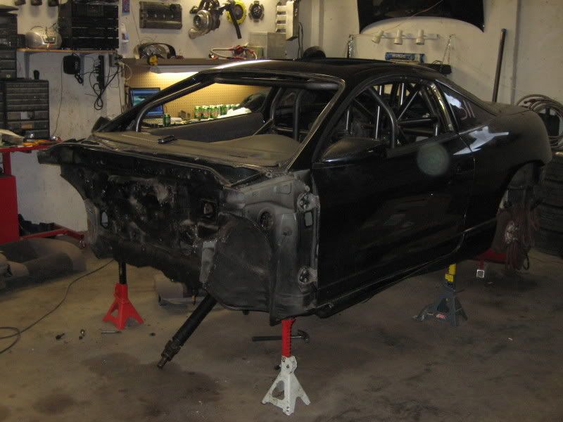

Anyways, I have been drawing up the front end of the car for a good 2 weeks now. Been kinda lazy with the holidays and shit. Things will pick up in the next couple weeks for sure!
The Evo hubs and control arms are ready to be picked up from the junk yard, suspension I just have to order it once I find out what springs I want to use, and I need to make a Jig for the front end somewhat close to where it originally was. As of right now the front end is completely off and ready to be assembled as a jig. Here are a couple pictures.

So are you keeping the factory shock towers? If not you'll end up in the fastest class. I think even Brent worked around using the shock towers and weaved the tube frame through the unibody.
Old 01-02-2007   #26
Re: Project Drag Talon
Are you building the car to run in any specific class or jsut for fun?
I think Brent didn't retain the factory shock tower, which has kept him out of the NHRA Modified class. He would have to run in the fastest class (Pro RWD) in NHRA.

I am ditching the strut towers... Pro Modified I believe is the class I will try to enter. All that is required is OEM Firewall and Floor to the B Pillar.
My car will be very similar to Brents car accept I might keep the factory K-member in the rear and stay AWD. Depending how business is, I might put a 4 link in the rear and finish tubing the back half as well. Just something fun to do and to be different. I dont really care if I can compete in a NHRA class.
I am basically just doing it for fun. If I cant run it in a class for some reason, that is fine with me. I'm just doing it cause I like to go fast and dont need sponsors to do it. I dont sacrifice much to race my car, I still live my normal day to day life, work monday through friday, get trashed on the weekends and enjoy working on the car whenever I want. I dont want to become Brent where his whole life is the car. From what I've heard is if he doesnt get a sponsor he's screwed. Thats not the fun racing I like to do.
