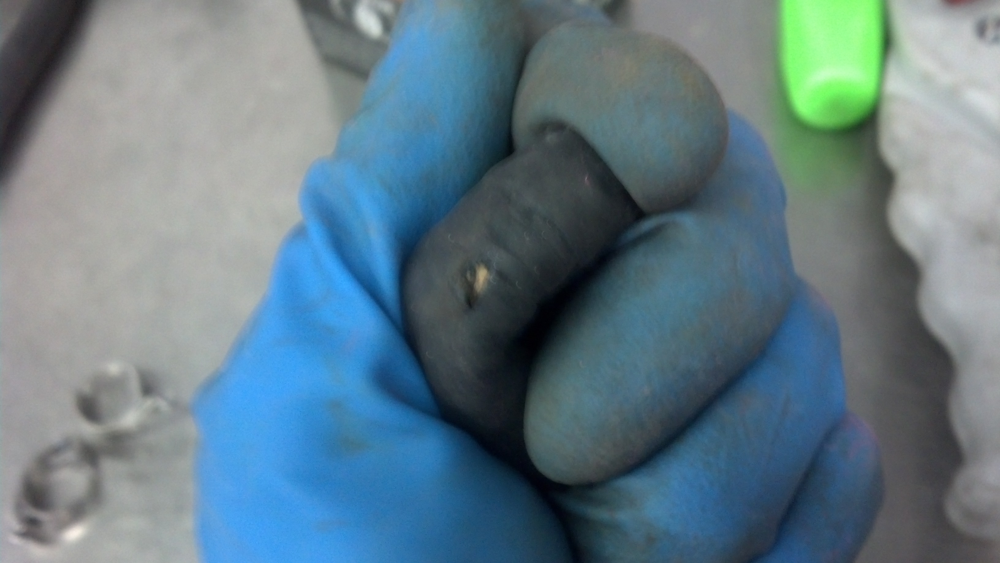

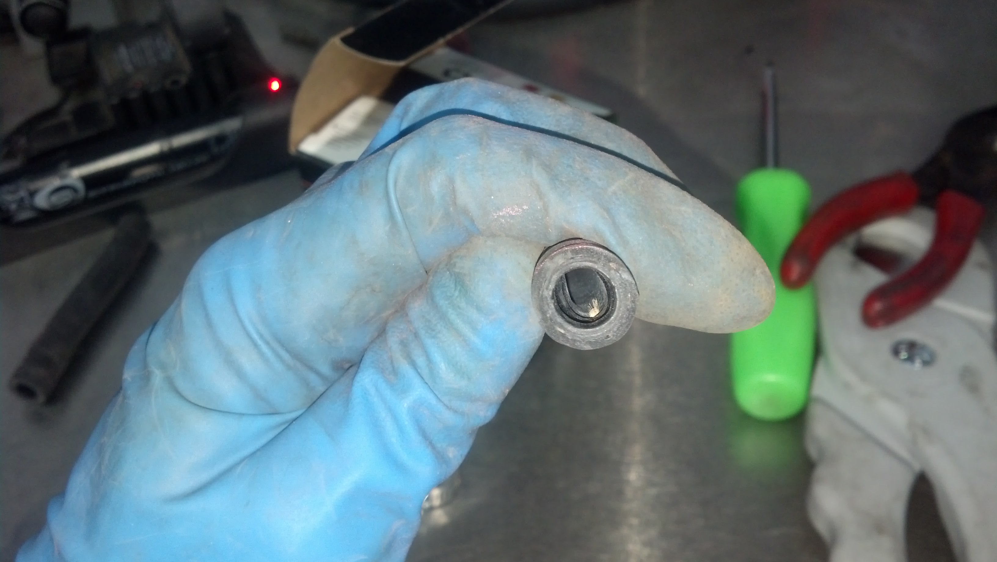

I picked up a couple 255s with the relief valve mod. Then when I picked up my car from db I got some submersible fuel line. I put the fuel pumps in and replaced the rubber lines in the tank. I did find a hole in one of the rubber lines I replaced. I did a couple 3rd gear pulls on the highway and the fuel psi just seemed to keep climbing so I think we're good to go. I'm going to talk to Shane and see what he thinks.
I also want to try and wire my wideband into the aem so I can log afrs and I want to get a fuel pressure gauge that has a 5v reference so I can log fuel pressure.
