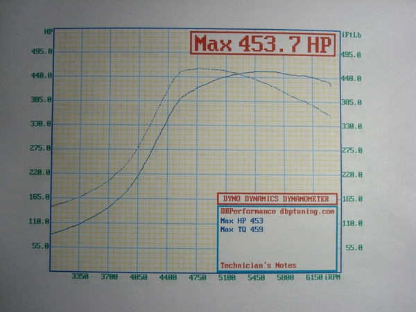

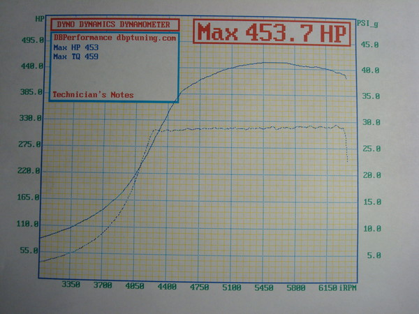

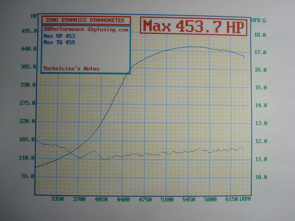

timing was still really low from 27psi on up, it would have been maybe 30-40hp higher. I stopped because of the clutch. Didn't slip on the dyno, but on the street, with the boost turned down, it did not hold.

Awesome numbers man. Keep it up

Badass! So new clutch and rock it for the summer? Or more bewst and re-tune once you have more clutch init? Nice numbers fo sho!

That's some ungodly torque.

Nice numbers!

I'll have to get a t56 and do that conversion so I can get a stockish feeling clutch that holds 1000 ft/lbs.
This was on 660cc injectors, btw, and they were at 95% duty cycle. With more timing and 30 lbs, it might be good for 500whp as is.

Supposedly "660s" even though they mathematically and from real world experience were acting like they were 1000s.

Get them flow tested? Make sure they are all flowing the same and know exactly what you are dealing with..

Holy rock solid boost control, this thing has to be a fun ride now!

Just a tial 38, profec b spec 2 and log manifold, Hehe. I really want a fancy header though. The car is far from done
