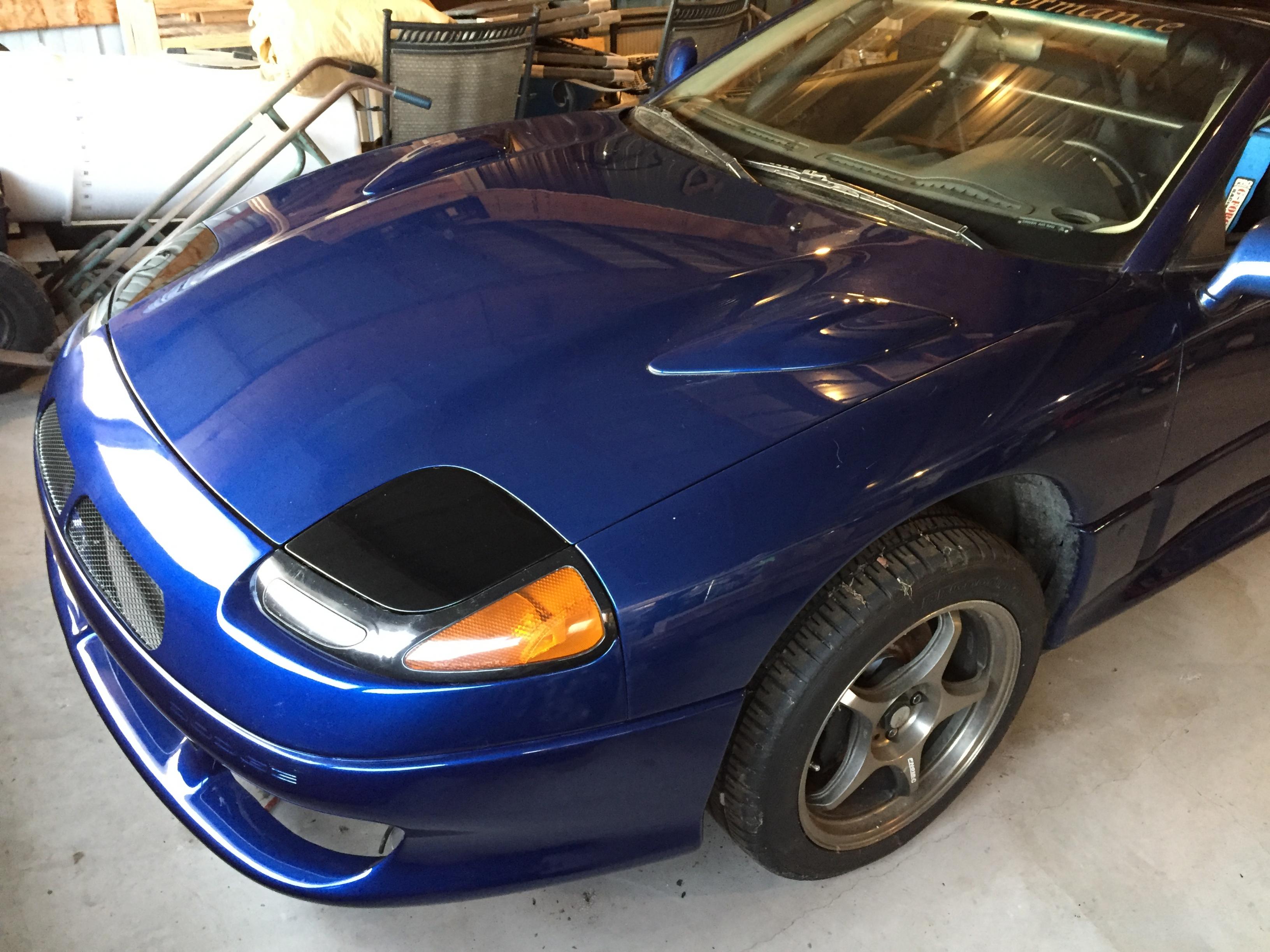

I finally have another Mitsubishi...yes this is my old stealth
Well I bought it back last weekend.
After selling it roughly 12 years ago I bought it back from the guy I sold it to. It came complete with everything I sold with it.

Name:	Stealth aquisition intro picture edited.jpg
ID:	17399   Click image for larger version
