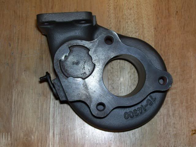

Wouldnt the solution with the test he did be to port the hole behind the flapper until its close to the size of the flapper? probably a ebay or amazon 16g ive read you have to do this to eliminate the boost creep on them.
http://www.dsmtuners.com/threads/evo...%C2%94.163103/
I could...... but i think imma take a different approach.
Imma run a 10cm t3 turbine hosing on my 16g. Then get a nice t3 manifold, with a provision for a external wastegate. Then get a flange for the o2 housing and weld an elbow on it and maybe do a v-band down pipe i have always wanted.
