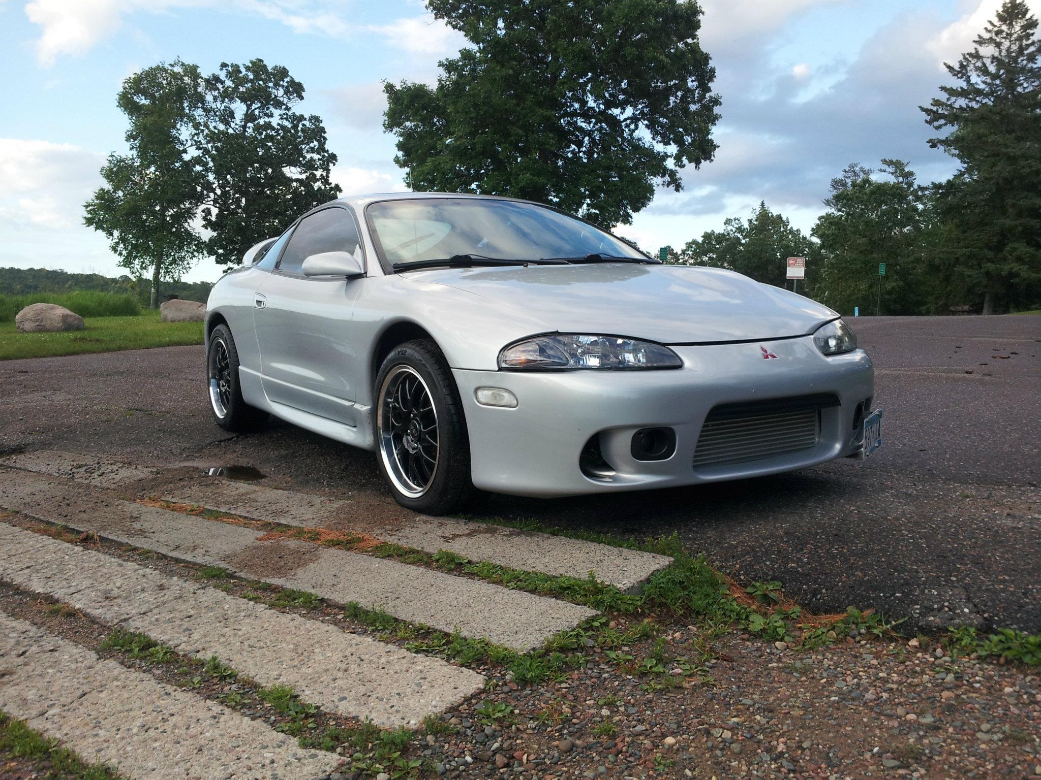

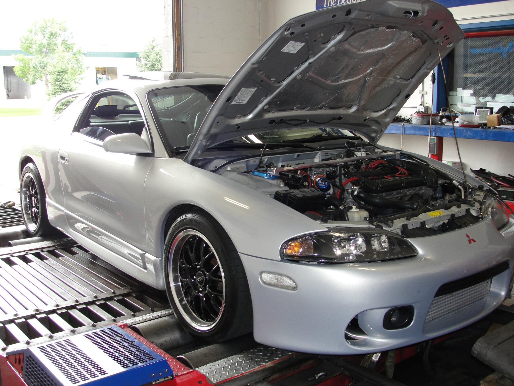

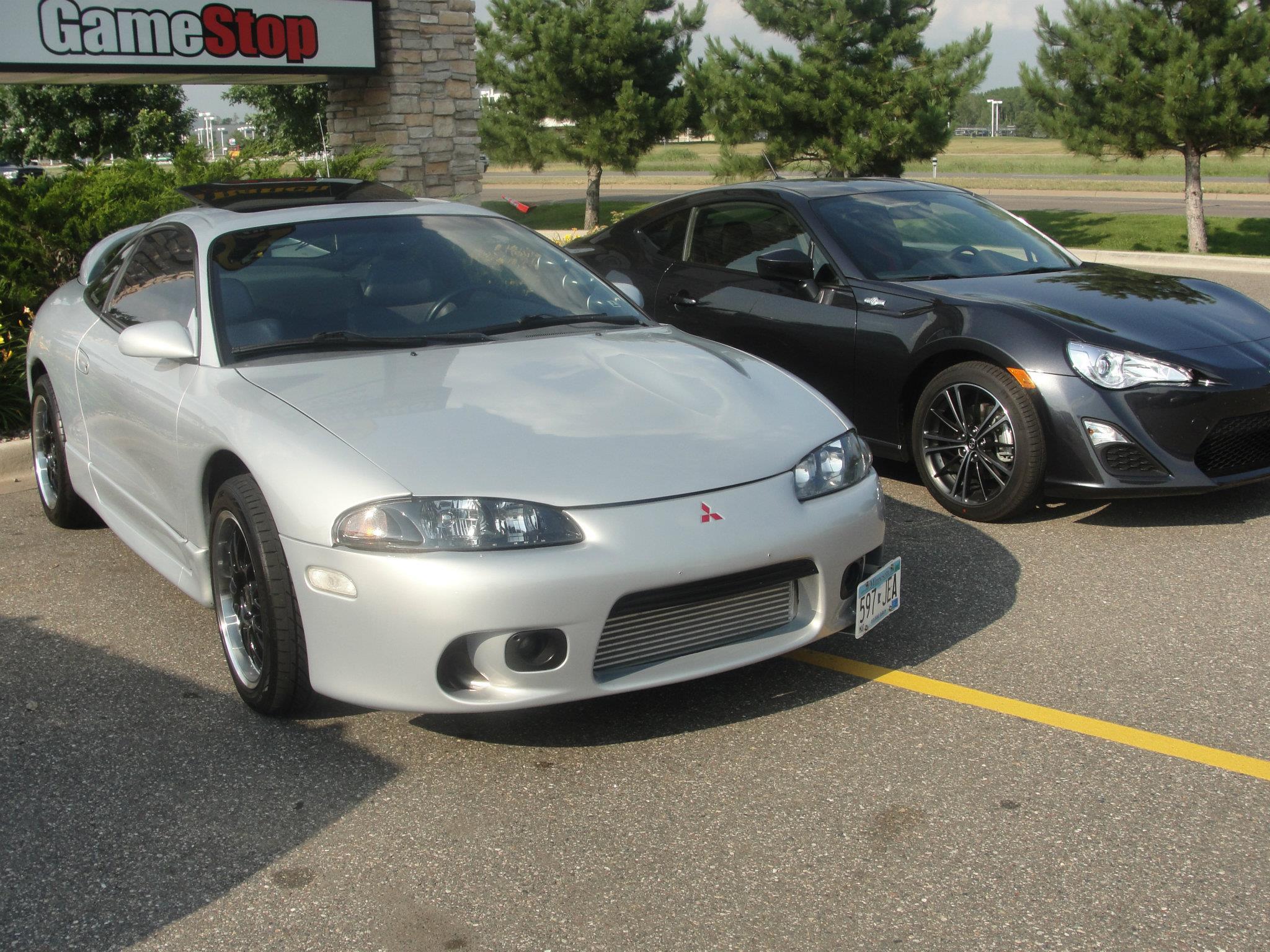

Some pics of my baby

That thing looks mint.

OMGZ FRS coupe! :drool:
