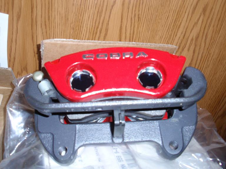

1st pieces showed up at the door today
Old 06-15-2009   #40
viridionplague
Posts: 788
Re: Cobra Brakes on a 1G
haha those look better than mine :P
