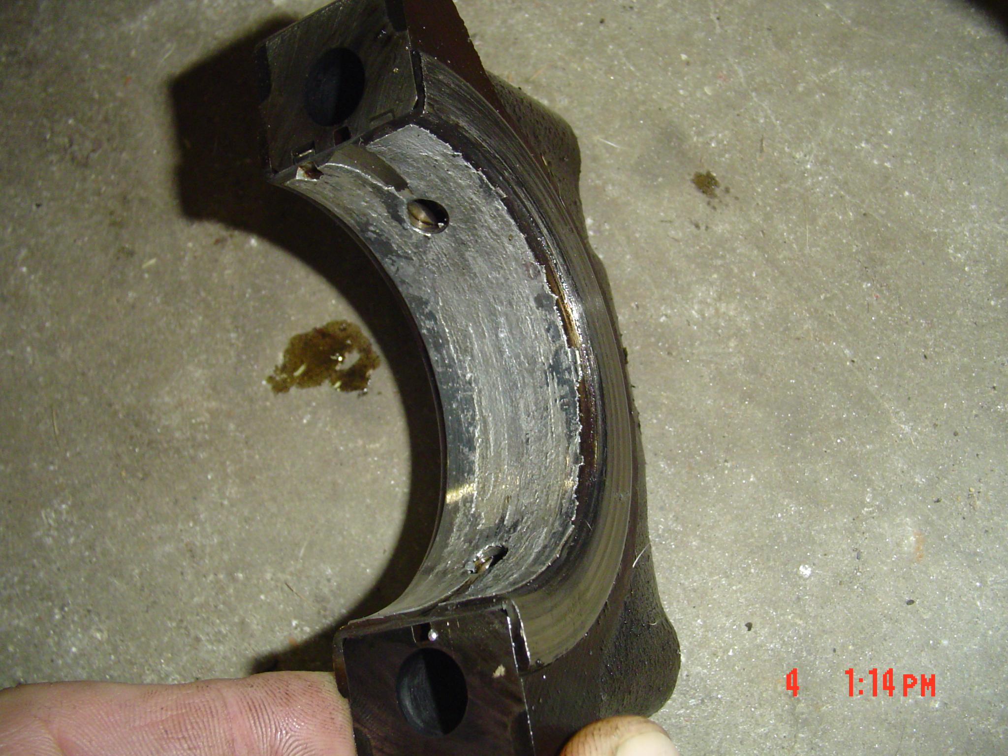

Old 10-04-2008   #13
CarPsyco84
CarPsyco84's Avatar
Join Date: Jan 2005
Location: Coon Rapids
Posts: 804
Re: motor loads when clutch pedal pressed
well 6 bolt motor guys should take note... you are not immune to crank walk. I didn't bother to measure the walk in this but its at least .020"
ID:	7801   Click image for larger version
