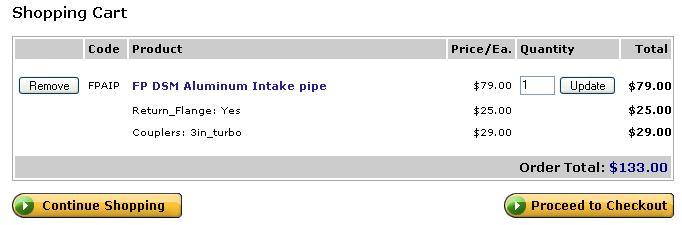

Just get the 4" FP intake, that way if you ever get a turbo with a 4" intake you won't be in this situation again. And it's only $79 base price, +$25 for BOV return, +$29 for 4"-3" reducer coupler for your current turbo.
EDIT: Kracka beat me to it...

Old 02-21-2008   #20
Re: intake dilemma
http://store.forcedperformance.net/m...ode=DSM-Intake
FP cast aluminum 4" intake, $133 with couplers and BOV return tube.
