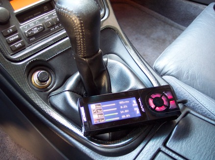

After getting some basics done I wired in an AFC NEO.
Now I know DSM Link is like the bible around here but the NEO is an affordable option for where I am at with the project. MAP got me a great deal on it so it was a too good to pass up.
The install was easy and the directions provided were accurate. I think it will be a good platform to learn from and it has more set points than past models. I do not have any corrections set yet so that will be the fun part and I'd like to get a wideband soon to replace Blinky. One step at a time I guess.
