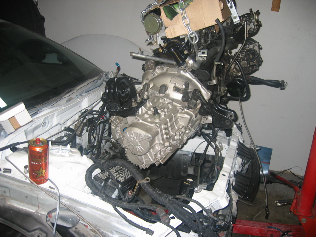

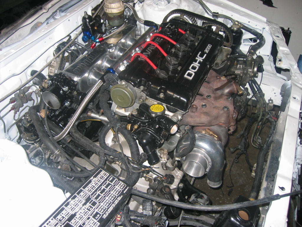

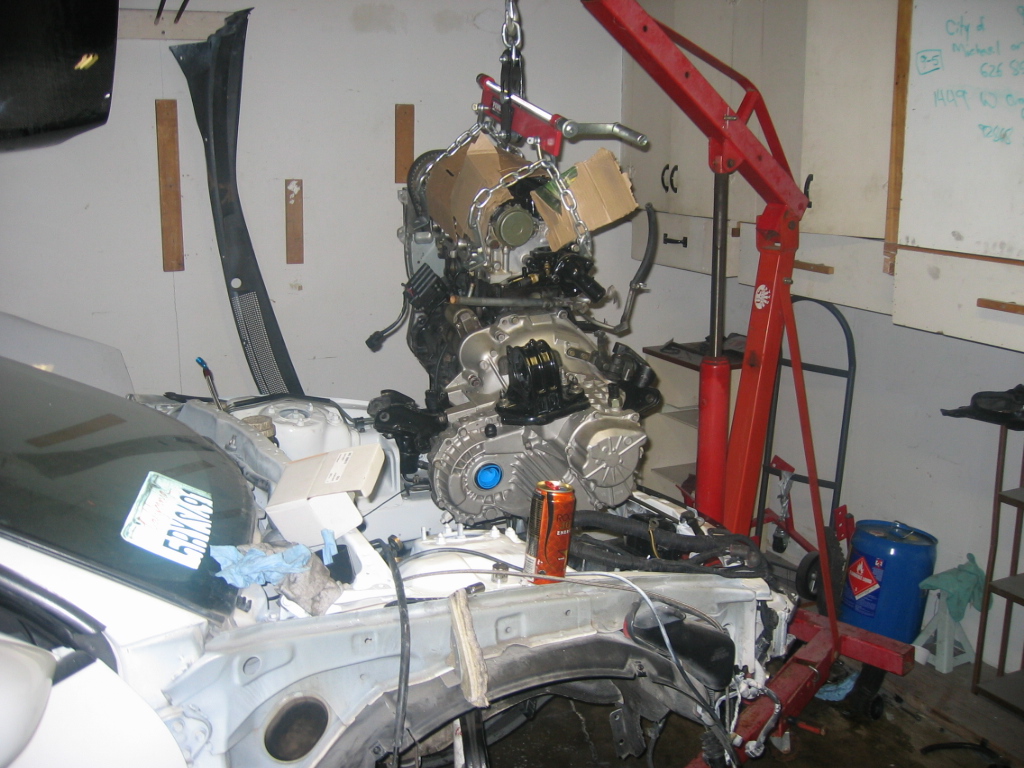

Ok the motor is in, but there is still much to do. It seemed like it was going to happen today but with the late start because the clutch still needed to arrive before starting, and with my roomate being gone for a couple hours. I ended up getting the engine in the bay and almost in all of the mounts by myself, my roomate arrived just in time to help finish getting everything lined up.
The magnus mani and fuel rail are mounted, the exhaust mani and turbo are mounted. Now it gets down to all of the details. Which sucks.
I was a complete idiot when i took this motor apart, i managed to lose a LOT of bolts. So tomorrow after i go to Apexi to pick up my exhaust i gotta go to Home Depot and pick up a shit ton of bolts. Also my new rims arrive tomorrow (Project2g is trading my GSX rims for the chrome rims that came on his car, because he is going to put those on the car he is selling)
Looks like im taking the day off tomorrow as well.
Tom

Old 04-26-2007   #38
Re: Toms Project...
Here you go.
ID:	5506   Click image for larger version
ID:	5507   Click image for larger version
ID:	5509   Click image for larger version
ID:	5510   Click image for larger version
