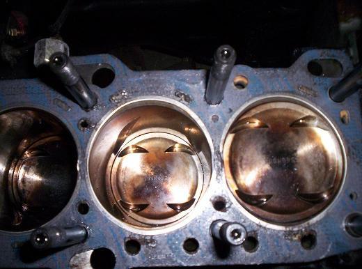

Just be happy this didn't happen to you. some serous detination blew the fire rings in the head hasket. notice there oval now instead of round, and blown between the clyinders. the stock head gasket saved me though no damage to the pistons cylinder or head.
11.35 @ 120mph
