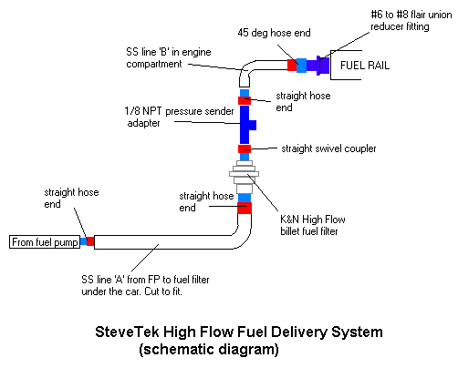

I was thinking about making somthung like this.

I would leave the stock fuel line from the tank, and change every thing before the filter to the rail, and get a different FPR. This pic is the main thing that bugs me. stock Vs 8 an before rail.

You can make a very good amount on most of the stock componets, the biggest restriction IMO is the fitting if you run lines to your factory rail. As seen in the pic it REALLY necks down. Dent Sport Garage will weld on AN fittings to the factory rail and it helps considerably!
In the somewhat near future I'll be running the Bosch 044 fuelpump, not sure if I'll keep the -8 to the rail or go -10, FIC 950s, keep my -10 Aeromotive rail, and -10 Aeromotive FPR, -6 return.
