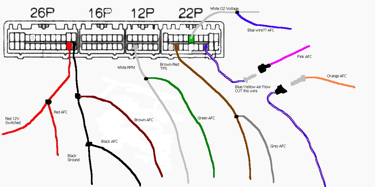

Here's the diagram for hooking up an SAFC I on a 2g (courtesy of Shane):
http://www.mitsustyle.com/forums/att...1&d=1185678388
As far as tuning, someone else will have to chime in b/c I'm not sure. All I know is that you'll have to get it tuned ASAP when you hook the SAFC I up, otherwise the car drives like poo and you may blow something.
I have a SAFC I, and the only verbal instruction are for SAFC II and as far as I can understand they are different. I am going to try to install the SAFC and get it tuned in the same day so I hopefully dont mess things up.
