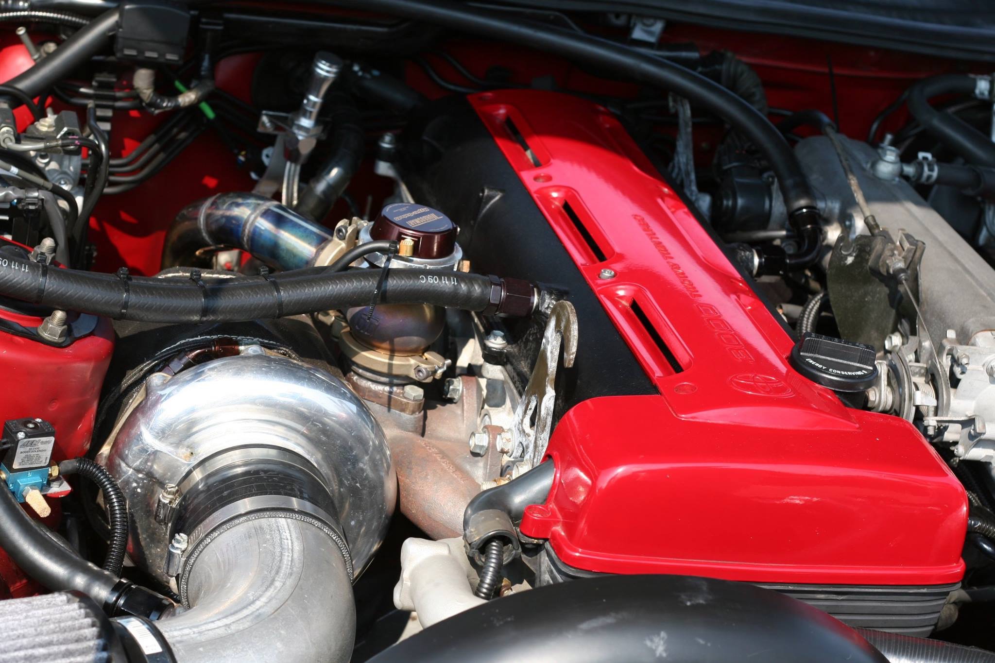

Cars running well. Mid build planning for late winter/early spring.
