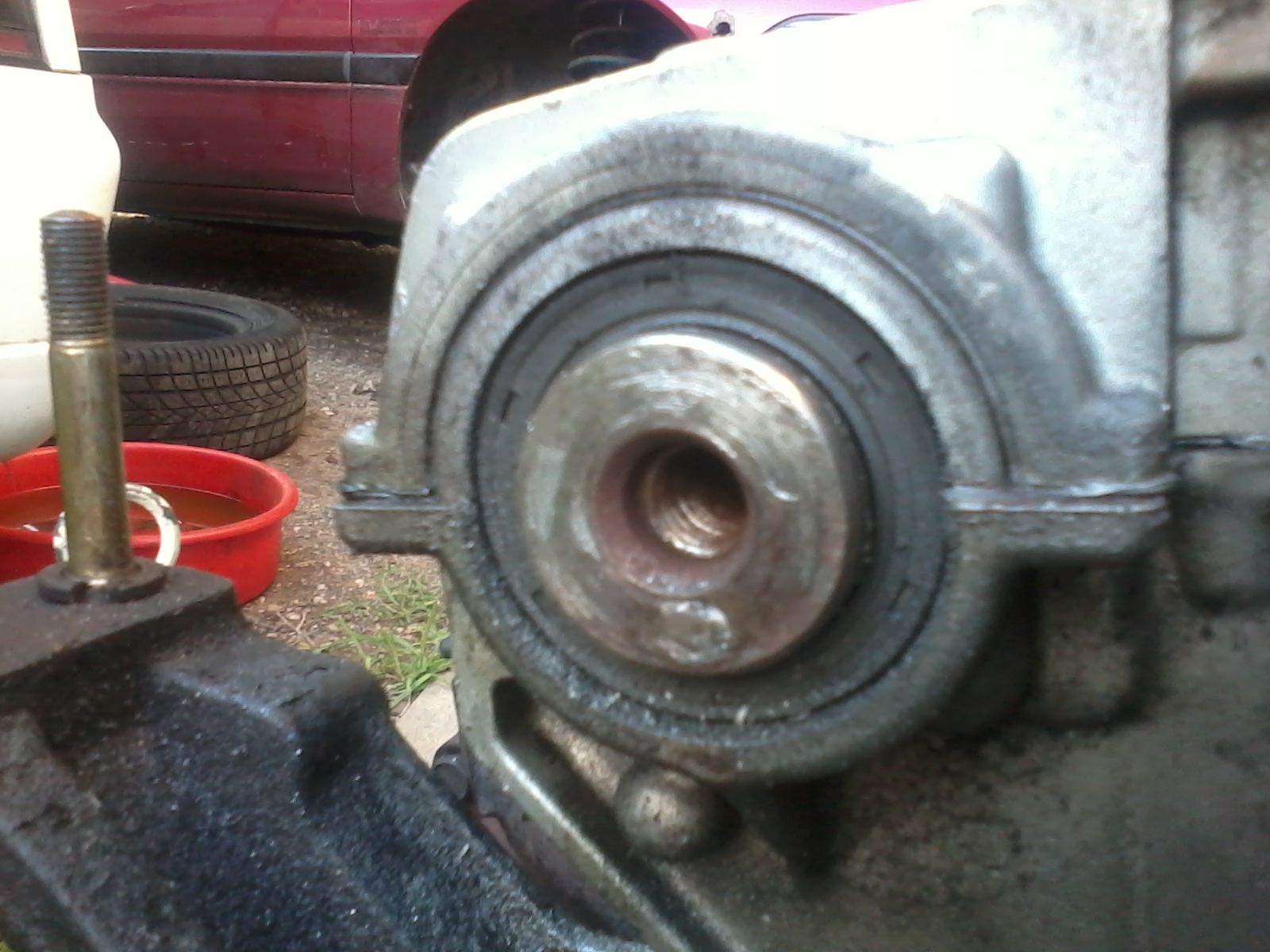

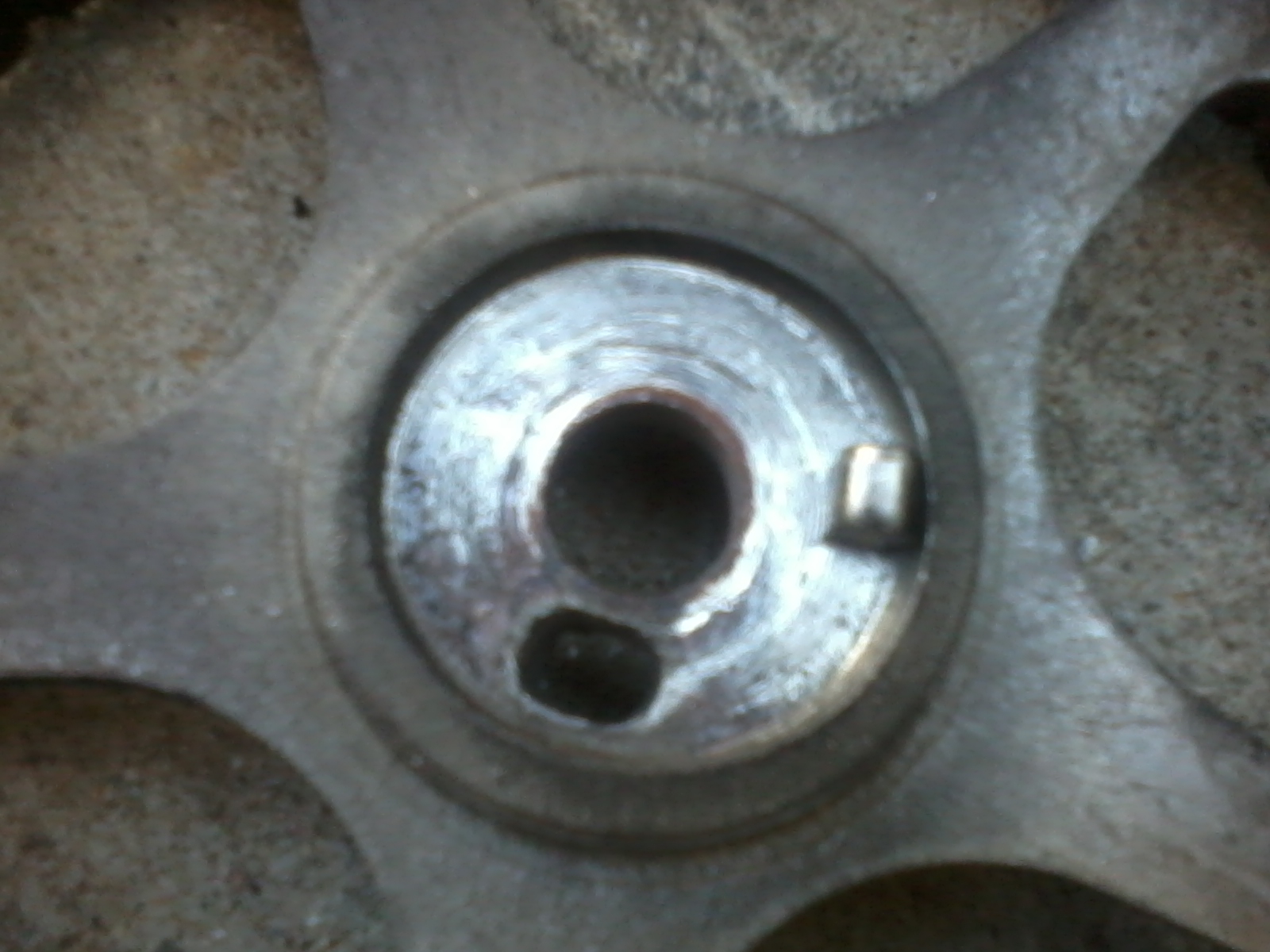

here are the pictures

The cam bolt loosened up, if the bolt is torqued properly it is the friction surface of the cam gear and cam that keep everything in line. This is a case of if you have an engine still running after the factory warranty or a ton of miles it might be a good idea to check everything over.

No red lock tight used on cam bolt ftl!!
