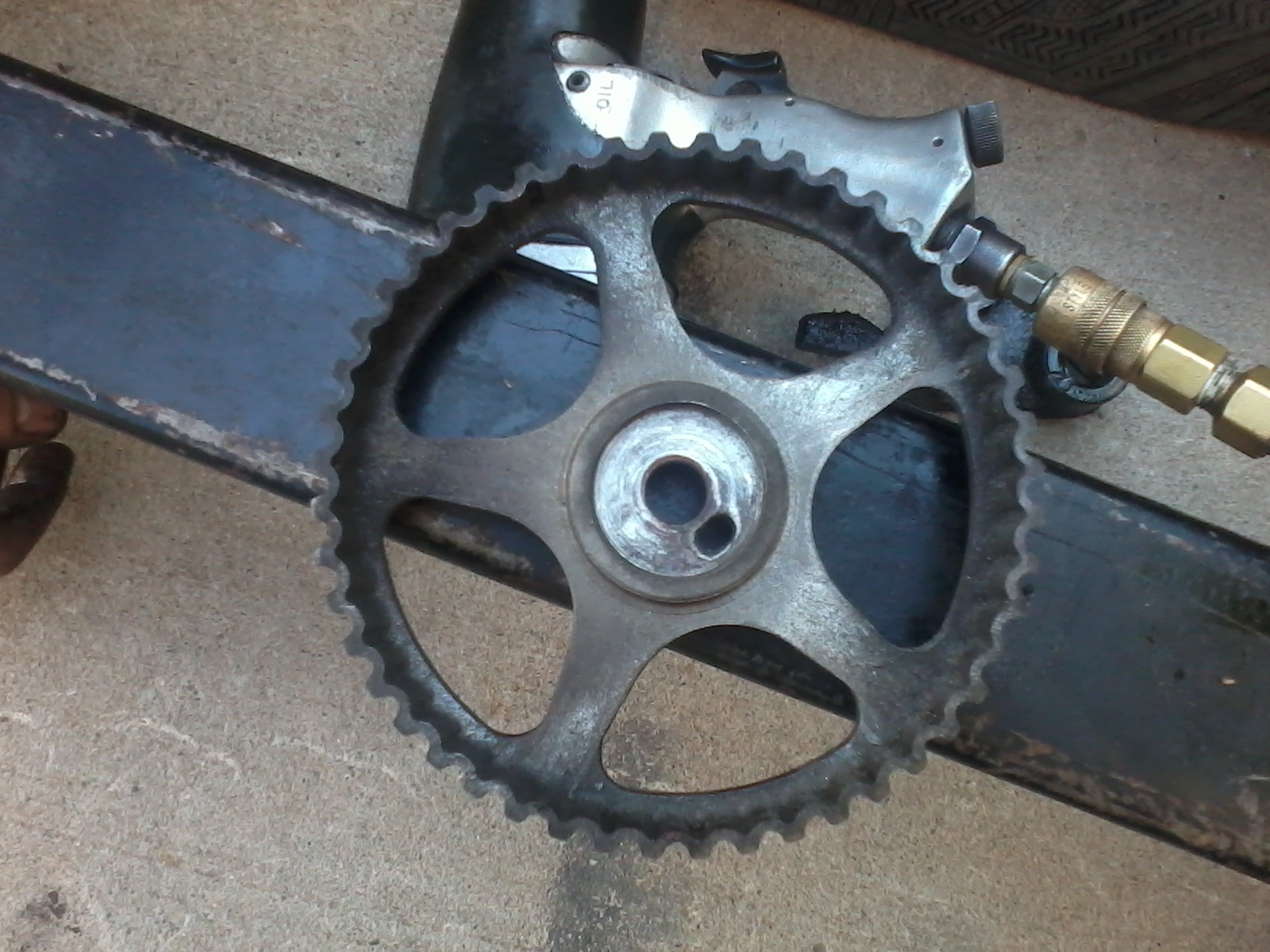

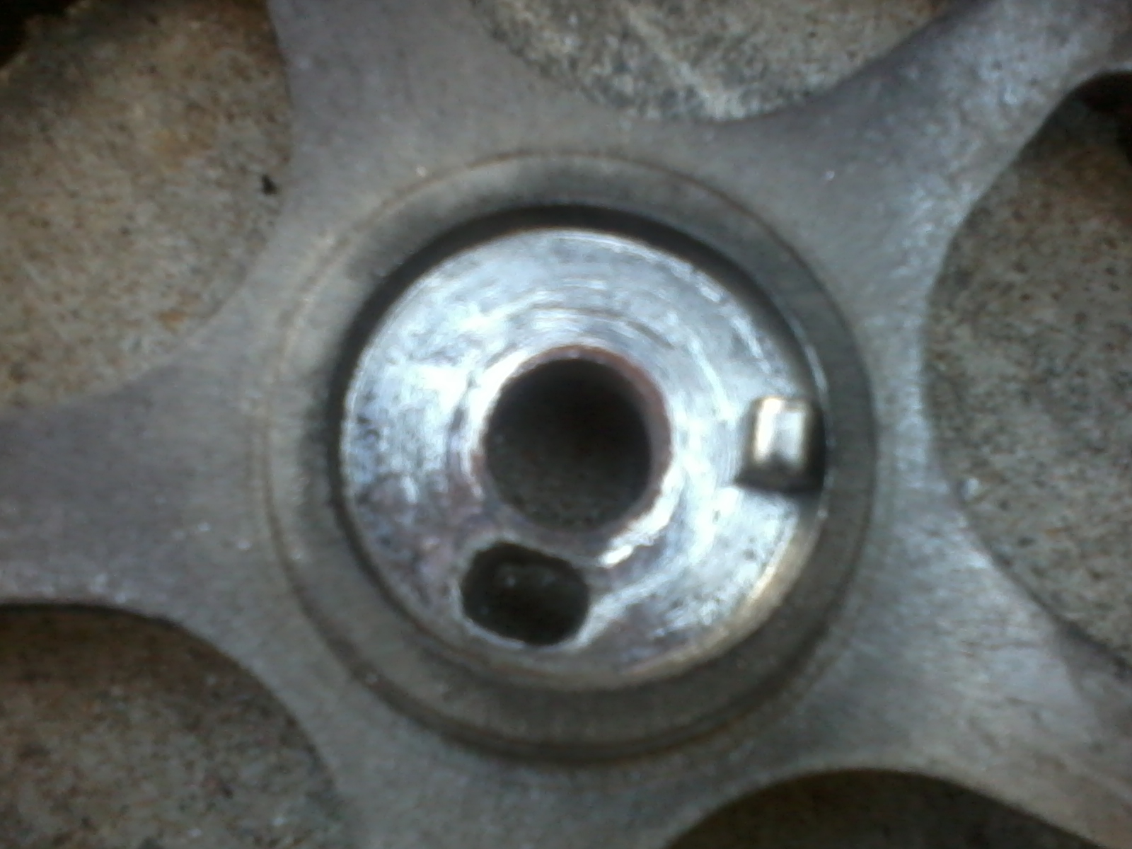

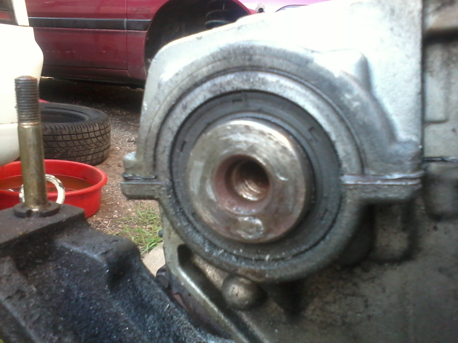

way2fastalon 07-25-2010 03:05 AM
Re: how do cam shaft dowl pins snap .. ?
3 Attachment(s)
here are the pictures
Attachment 10370
Attachment 10371
Attachment 10372
Pushit2.0 07-25-2010 05:02 AM
The cam bolt loosened up, if the bolt is torqued properly it is the friction surface of the cam gear and cam that keep everything in line. This is a case of if you have an engine still running after the factory warranty or a ton of miles it might be a good idea to check everything over.

way2fastalon 07-28-2010 09:21 PM
the funny thing is the cam's where never touched ... all stock just did the t belt changes every 30,000
santa 07-28-2010 09:55 PM
No red lock tight used on cam bolt ftl!!
