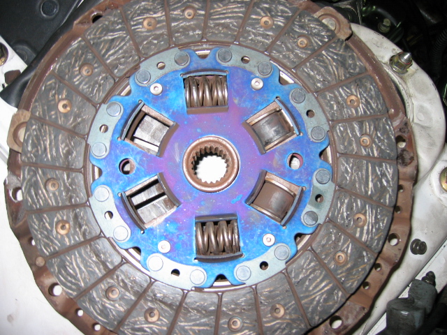

OK so i decided to take the day off and pull the tranny and then pull the pressure plate to check out the clutch (should have done this earlier) and heres what i found.
Two of the rubber peices are shredded.
Is there any places that sell these seperately so that i can just replace them and get my car running?

Time to buy a new disc. You are better off using an OEM Mitsu disc with the ACT PP instead of the ACT disc since they have known quality issues.

ACT just revised their sprung disks. I have sitting right here. It would now be very difficult for a spring to liberate itself!

How do you know if you have the old one or the revised one?

its an ACT 2100 Clutch, im just gonna go get an OEM mitsu one from a dealership i think.

Call ACT, they might send you a new one under warranty. I've never seen that happen before.

I second this idea. If you had the old un-revised disc, maybe they would send you a brand new one since you have an unusual issue.

My ACT disc has yellow springs in it, doesn't look like that one at all. Is there a way to tell if you have the revised one?

yea yellow springs is the new one. and it should have ridges of sheet metal partially covering the springs.
