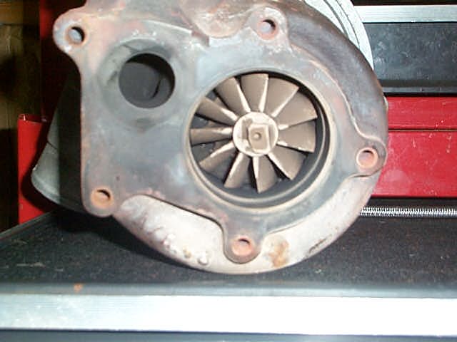

anyone know how to tell from just looking at it? here's some pics. I know it was from diamondstarmotorsport.com, and they do both turbonetics and pte stuff.
Anyone have a mitsi-flanged turbine housing that would work on this thing?

Looks like one of those 57-trim/60-trim T3/T4 turbos that were sold by places like TurboCalculators for $450.
Old 12-01-2005   #7
Re: T3/T4 5-bolt setup: looking for opinions
really...so, junk then? Or still worth buying? Damn!

It all depends on price. If it isn't blown and the price is right, then it would be worth buying. It will make power.
