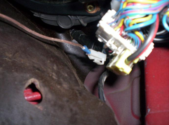

There should be a wire behind the passenger side kick panel you can splice into. i can get a pic of mine if you need it.

heres a pic you can see where I taped into the plug with a spade terminal
the pic on post # 5 is as good as it gets.
