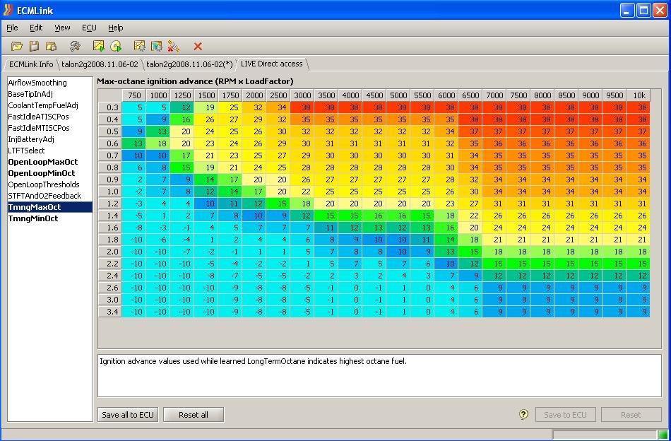

As soon as I saw the 2D timing tables on ECMLink, I put down the laptop and haven't looked at ECM link since.
