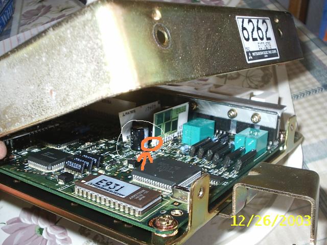

this is the ecu from my 92 tsi. i cant get the cover off all the way because of one :censored: screw. i tried for a half hour and there is not much left of the screw. so i just lifted the edge of the cover enought to get a pic.

Yes, the large chip right in front ther labled E931 is it.

thats the cap that leaked on mine....burnt all sorts of things yet it still runs, just fuel cuts at about 4500rpm hmm party :bounce:
