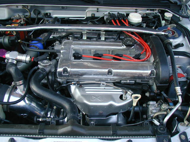

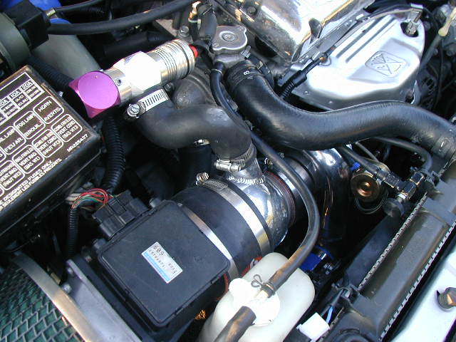

I have the 4" FP Intake on my 99 GSX. There is no problem with the 2g MAS. The only problem I see is finding a reducer from 4" to 2"(or whatever the inlet on a 14b is).
I have a 4" to 3" reducer for my 50trim that you can see in the picture. Find the right reducer and you should have no problem making it work.

.... another pic in addition to the one above
