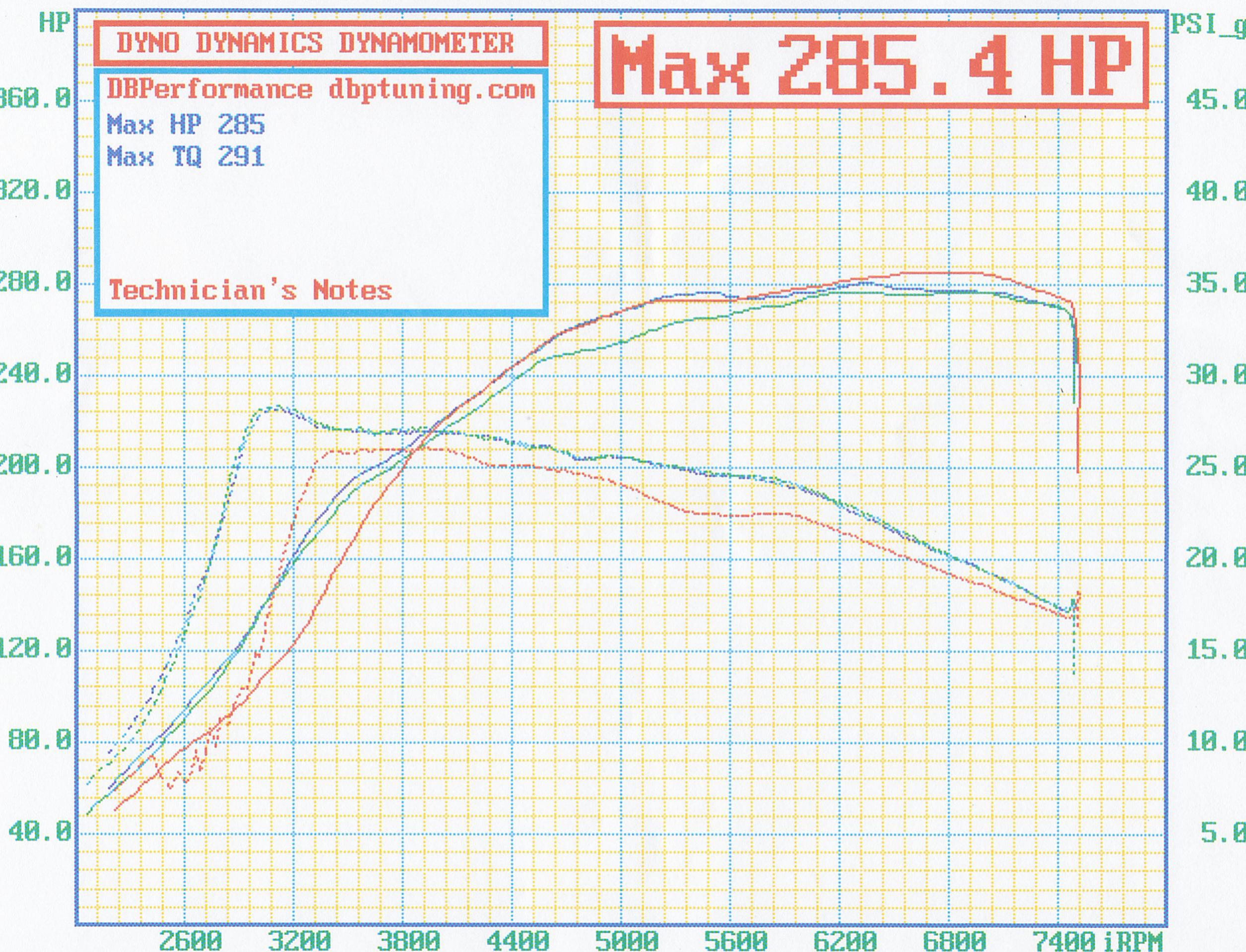

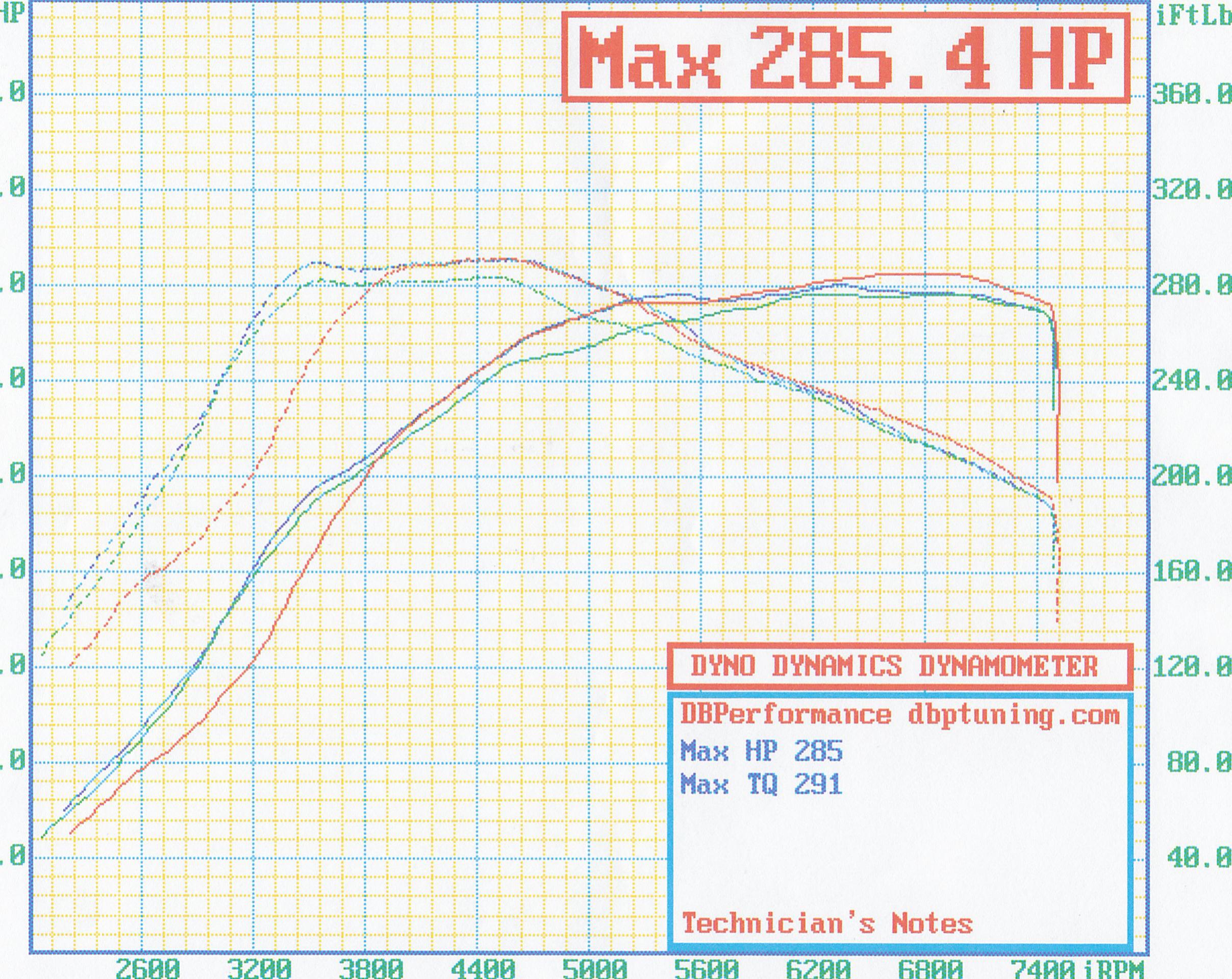

*** This is not an offical test of all the Dyno's in the area, just a couple of sheets for a interesting read how different dynos read.***
Car: 2008 Evo X - Boost Pill mod, AMS down pipe , UR HFC, Magnaflow Catback w/ modded inlet, and K&N drop in filter.
Tuned by Ron @ RSMotors,
The older sheets from the other dynos do not show the boost like db did , it would be good info to see how the car gets loaded on each.
Current Tune @ RS:

MitsuStyle Spring Dyno day @ DBperformance:
Boost:
Shootout Mode:

What is cool about the graphs if the torque and power curves look pretty close to identical (ignoring the actual numbers of course).

MAP=340whp
RS= 323whp
DB=285whp
Add in some weather/wear fudge factors but this is pretty neat comparo.

Re: One car, same tune - 3 dyno sheets.
So 15% gain from DB to MAP is reasonable...this was 19% but I don't think that is too common, probably weather or something.
I think from now on I will just assume 15% and not worry about dyno'ing at different spots, my boost control method doesn't like dynojets anyway.
