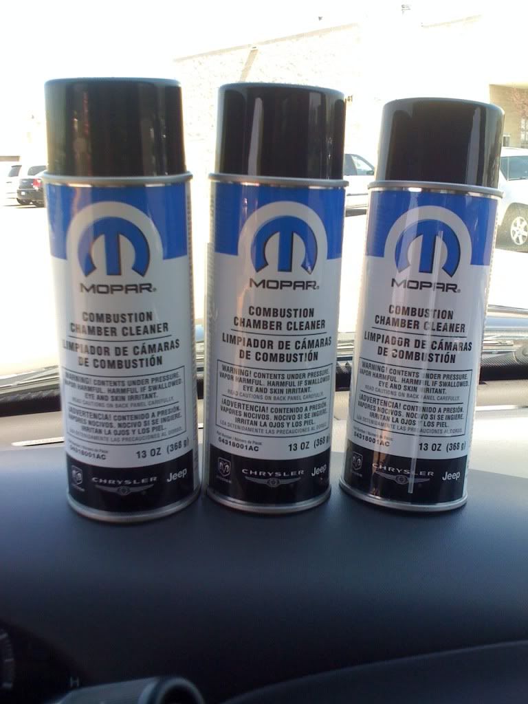

Im down! Im going to call Ron tomorrow and see if he will let me borrow his scope you were talking about. Then we could really see in there since its a camera!

I hope this stuff works!
Scheides, Matt D and I will be tryin this out on my car Sunday..
