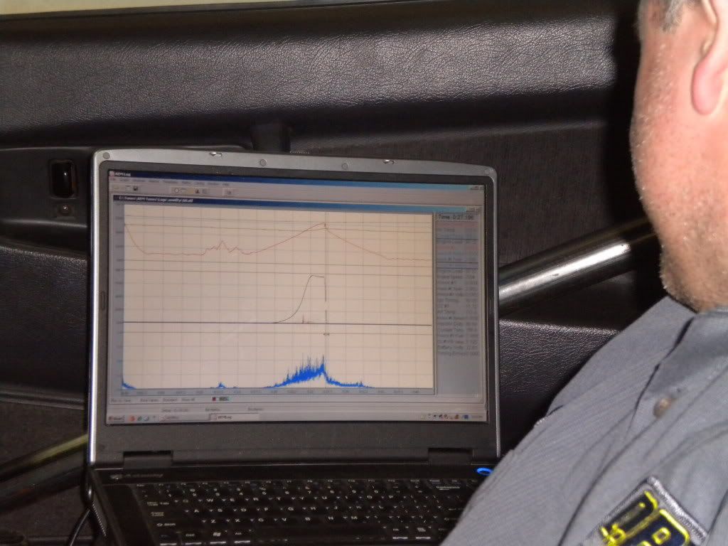

First off, my motor is noisy, always has been, always will be..dunno why. Proof is in the pudding..look closely at the blue..that's knock.."phantom" knock, with a few counts of real in there..

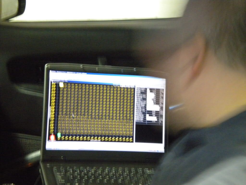

Shane worked his magic in a rather quick manner..
And the results are..ok. I can not fault anyone for the tune or etc, but myself and the car. I will first give a HUGE thanks to Shane for staying soo late with me to work this out, and sort some issues. Also, Thanks for John to stop by and lend a hand. And, the few peeps that showed up
