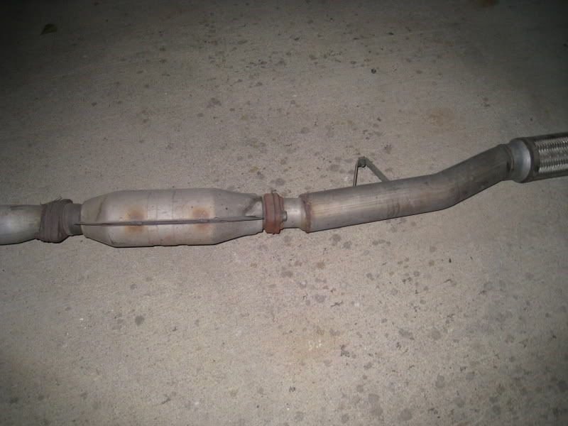

My car came with a Buschur exhaust on it..
.. and this:
My solution:
Was pretty loud driving around with it open
kittay is offline   Reply With Quote

Haven't had any problems with mine, other then it didn't close 100% and started to give phantom knock.. lol
But we have the toggle switch, just hit it down and it stays open, don't have to hold it
