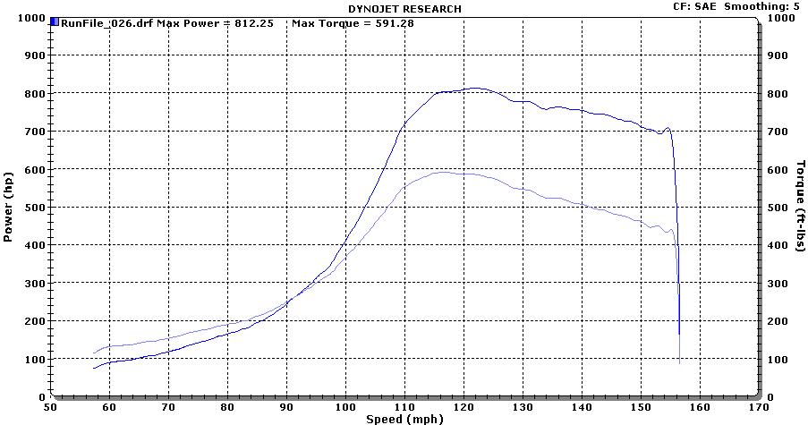

FDSM Dyno Results...Finally lol
After a long night of tuning we got it to:
812whp and 591ft/lbs
Boost: 43 psi
Fuel: E98
Automatic Transmission
Bias Ply Tires
It has a lot more in it, we simply ran out of time. I'm thinking we can do 900whp on the turbo, but its looking like we will need to juice it into the quadruple digits
Click below for the video!
Big thanks to Jordan @ Consummate Tuning for staying late and helping out with the tune!

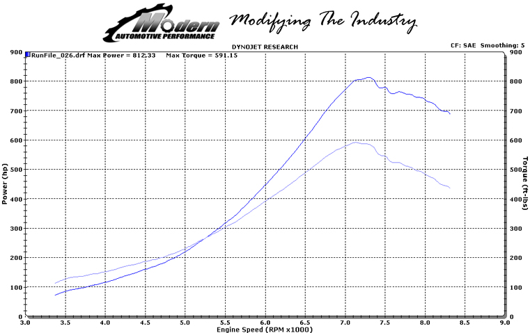

We sent it out to AEM and they didn't find anything wrong on their test car so they updated the firmware and sent it back. During that time our USB to Serial adapter took a crap so we're thinking that might have been the issue as the AEM would only freeze when the laptop was connected.
We were revving it to just over 8k last night, but we might need a little more to ensure it falls back into the power band. Check out the HP vs RPM graph below:

Nice numbers! Especially through an auto. I wonder why it nosedives so hard at 7300 rpm though? I can't think of any bottlenecks from looking at the setup unless your cams aren't keeping up. I'm guessing there's a lot more in it.

Could definitely be tune related as we just scratched the surface, or perhaps an upgrade to 288's is in order
