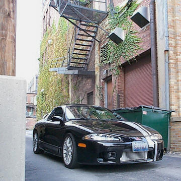

This 6 bolt has been well worth it. .Compared to the 3 7bolts we had in it before.
CrankWalk is a Mother F :censored: r
