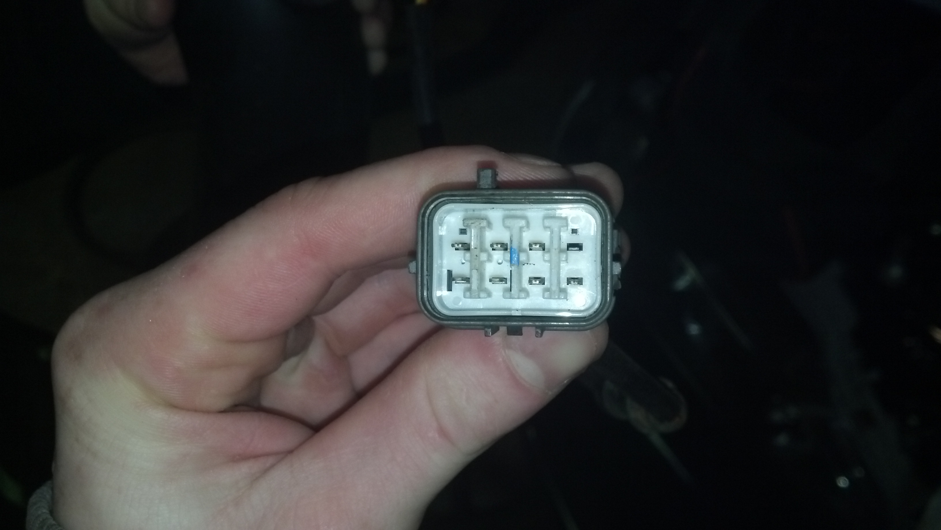

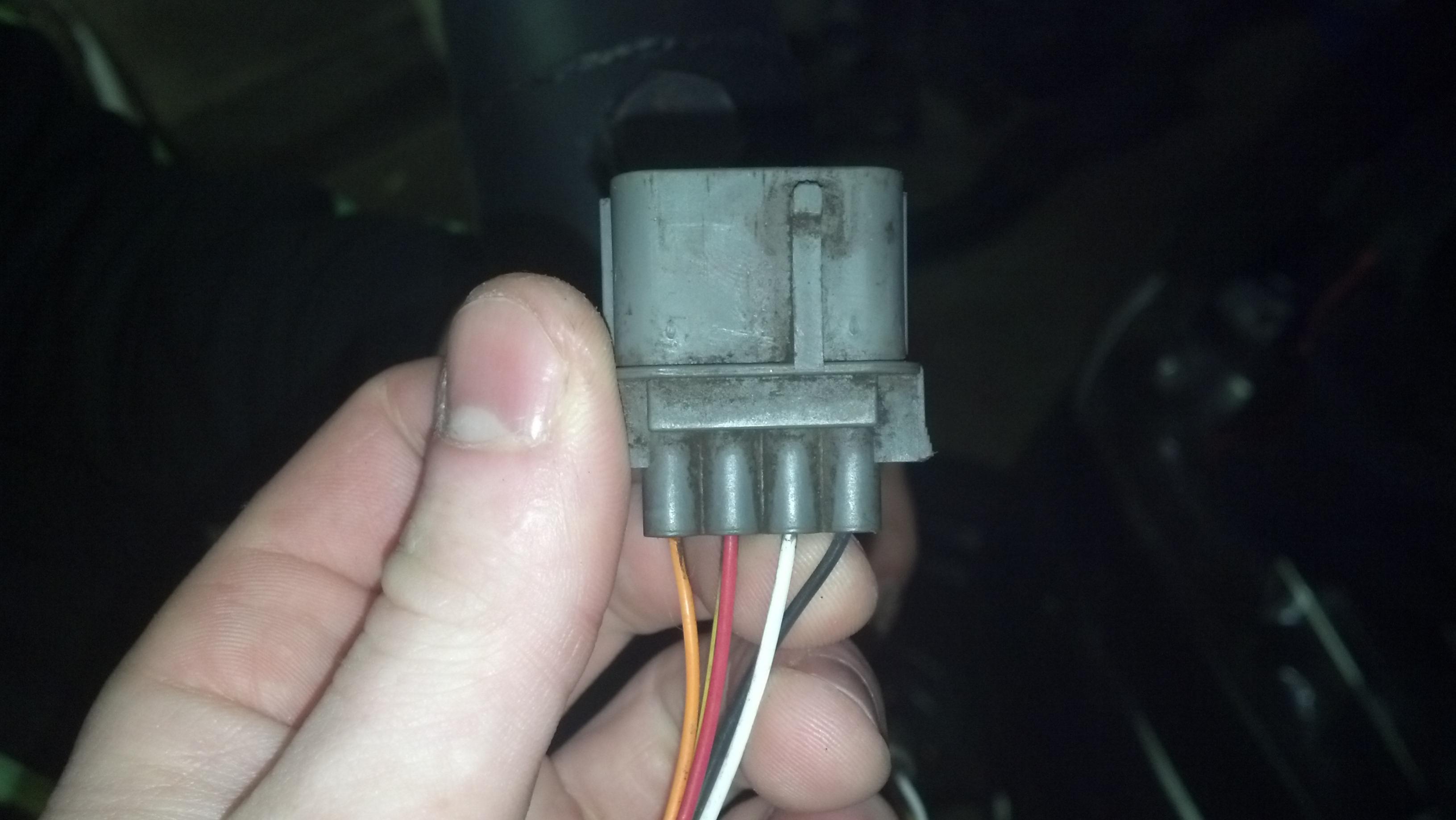

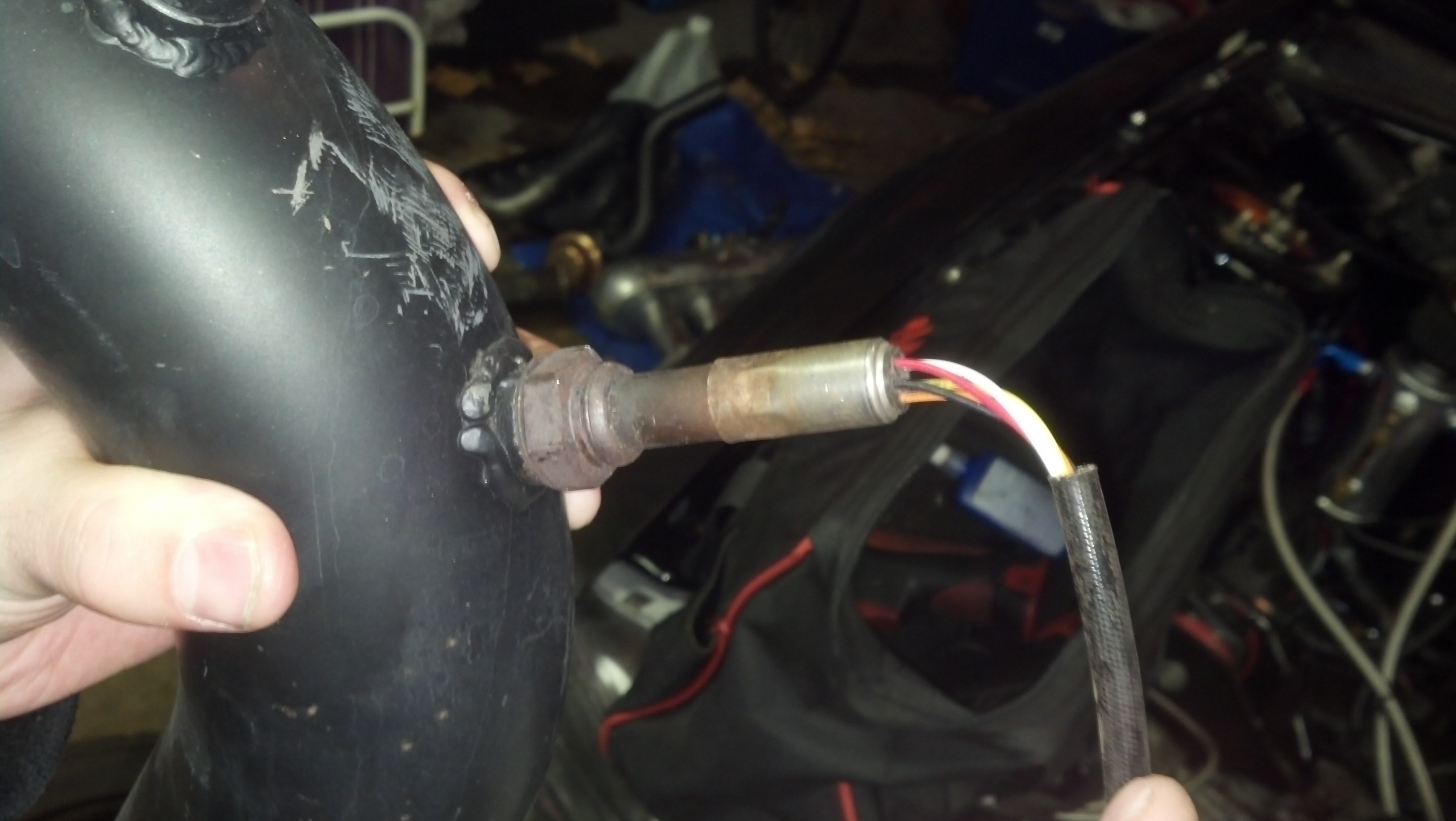

The only numbers I could see on the sensor was L1H1 and CS000. Here's a couple pics too

It looks a lot like the NTK sensors I use, but the wire colors are different. Same connector.
I think the L1H1 NTK has been discontinued and replaced with the L2H2.
Okay cool. So then would an L2H2 work in place of this sensor? And are they something that you stock?

I don't stock that sensor. The L1H1 was used on some older Hondas.
http://www.oxygensensor.net/ntk_o2/24300.php
