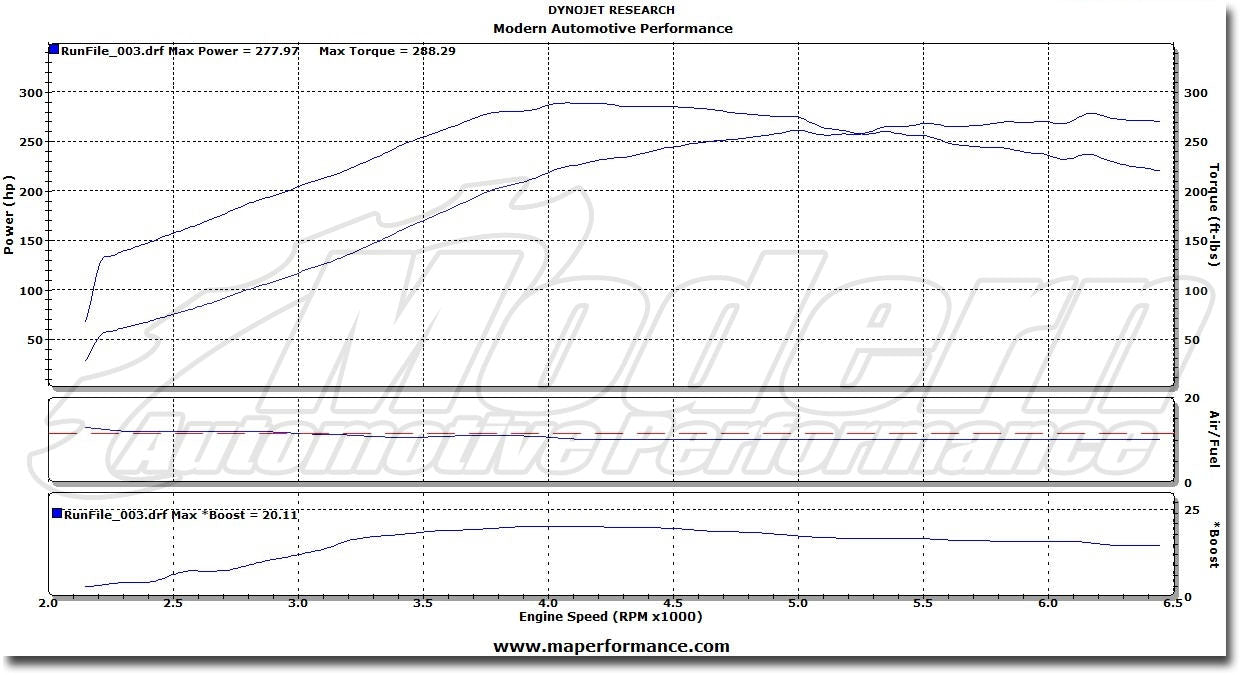

We've got big plans for this project, which is also my daily driver, but I can't spill the beans just yet. This thread will document the entire build process including installation guides, tech articles, and dyno results. Below is what we're working with as a baseline on 91 octane, it's hard to tell but this thing is super rich, a tune alone should yield substantial gains. Your comments and/or suggestions for the project would be greatly appreciated

I thought about this more....the current power level.
This seems to be at or around the '10 and '11 stock power level with the better tune. Do they have a new updated flash out now (the dealers) that they put on the car?
Still trying to figure out how the hell it made that power stock, lol.
We'll have to wait and hear if it is stock. My car hit 280 with bolt-ons and no tune. If boost is bumped or there's at least an intake/cat delete then it's quite possible.

Re: MAP's 2008 Evolution X GSR Build Thread aka Project GGX
It's right in the first chart. It looks like it hits 20psi by 4000rpm and falls to about 15psi. I'm not sure what they run stock.

Yup. I've seen stock 2010's do 23psig on the dyno, but I'm sure a lot of that depends on loading so "only" 20psig on a DynoJet doesn't surprise me.
